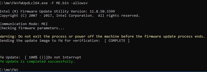

 Asus fournis un utilitaire pour mettre à jour le firmware Intel ME automatiquement et sous Windows pour la série des cartes mères ci-dessous.
Voici la liste des cartes mères:

Pour la Série Z370, Asus ajoute une mise a jour du bios apportant quelques améliorations que vous pouvez retrouver ici.
Informations d'Asus:
Intel has identified security vulnerabilities that could potentially place impacted platforms at risk.
Intel has validated and released a ME and software updates that address the identified security vulnerabilities.
Thus, we strongly suggest you to update your ME to the latest Version via using MEUpdateTool as attached.
*We suggest you update ME Driver to the latest Version 11.7.0.1040 simultaneously.
Release note:
Fix) Mitigated security vulnerability.
•(Fix) Failure to confirm remote configuration is enabled when running Intel(R) Common Services FW compliance test CS_040
•(Fix) Failure of Intel(R) ICC FW compliance test ICC_TST_02 at test step 4 with an error message "HECI CMD Status = 0x00000034 (NO_SUCH_TARGET_ID)".
•(Fix) FWUpdate will fail in case image includes Pre-update module
•(Fix) Playready DRM returns wrong value.
•(Fix) Failed to Get Record via CCT tool with INVALID_PARAMS
•(Fix) ICCWDT is not universal driver
•(Fix) Remove win7 support.
Download Asus Firmware Update ME Z170, H110, ... & Z270, H270, ...
