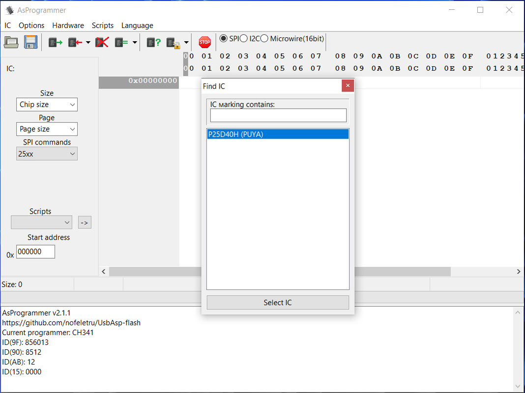

I desoldered the SPI chip a couple of days ago on the Cofre Disco Duro FW 9.32.74 and dumped its contents hopeing to be able to separate the
Golden Firmware from the main Firmware and such there may also be an led.bin in there for the disco lights
couldnt seem to work out the firmware structure
if any hex editing gods are here it would be nice to get a backup of the firmware from the dump that can be flashed via MPtool_lite rather than having to flash with a programmer
files are in Realtek RTL9201R\Other\Cofre Disco Duro 9.32.74 SPI Dump

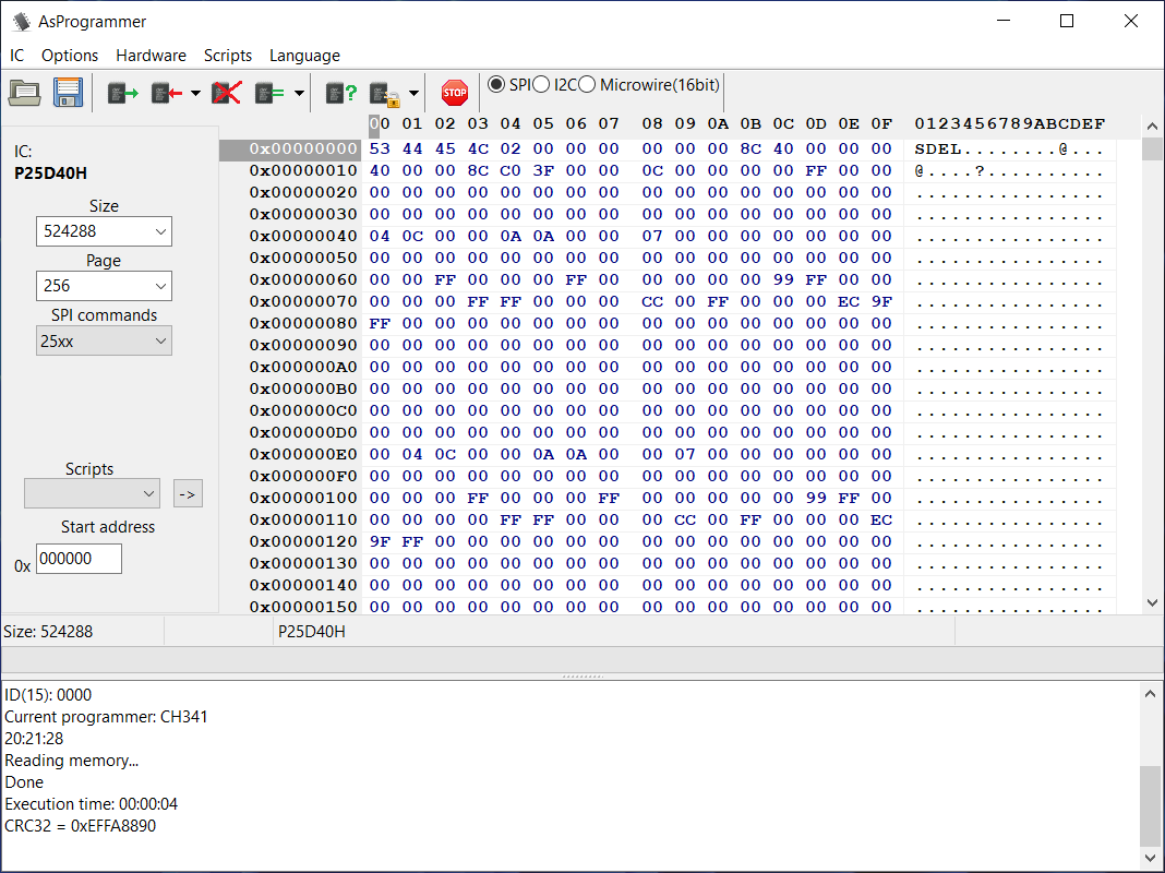

A Cofre Disco Duro that came today has the new firmware on it
will take a spi dump of it at some point

Added SPI Dump of Cofre Disco Duro 1.33.88 18th July 2024
Its in Realtek RTL9201R\Other\Cofre Disco Duro 1.33.88 SPI Dump
mega.nz/file/Aroh2KTB#Lz6PzPtUGrD0bBjRFY...a3D_kxUkv2EvRU8Yfb_c
