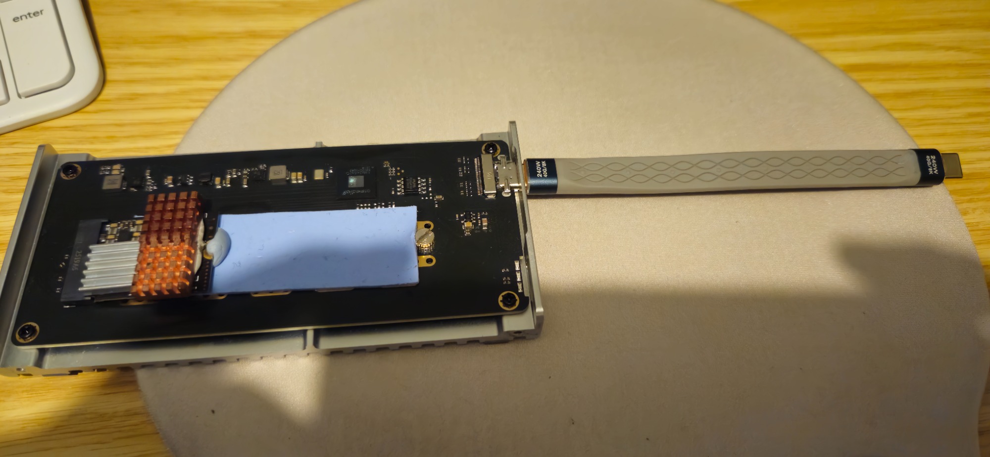

I got 2 UGREEN 40GBPs enclosure's that use the asm2464 chip's and I was wanting to get longer cables as the cable that came with mine is really short,I was wondering either if of you guys has ordered any aftermarket 40GBPs cable's that are longer,the reason I ask is because I know ordering usb cables can be hit or miss when it comes to finding a good brand.
I think I also read something about not going past 30CM in length with 40GBPs is that correct.

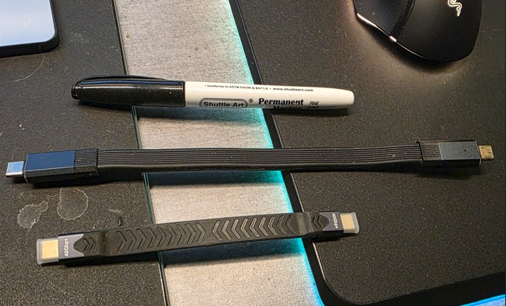

I found the 20 or 30cm cable that came with my enclosure
that is supposed to work at 40gbps didnt work on my 11950H
gen2x2 instead of gen3x2
ended up using 10cm flat cables it operates at 40gbps now (gen3x2)
so no havnt tried any longer ones

This could also be due to the disk not being recognized; it happens, hence the importance of updating the firmware regularly. As Shonk rightly said, I have a 10cm cable and it works perfectly.

I have my 13cm cable that cost £1.99 from aliexpress which works perfectly fine at 40gbps transfers, its anything above that fails (0.3, 0.5, 1metre+)
This one here works fine:
Maybe USB 4/Thunderbolt 4 devices only like 10-13cm cables?
I think ill try 1-2 certified thunderbolt 4 0.3 cables, after that its probably powered thunderbolt 4 docks/hubs that's required
