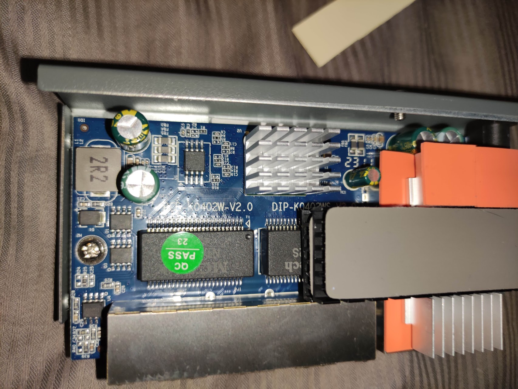

Here's what i ended up doing with all of my switches SFP+ Cages
Most dont need it but the cooler the better
12 Port 10 Gbps Switch 8 10 Gbps RJ45 + 4 SFP+ (doesnt really need it as it uses optics + dac on SFP+ and has a fan but cant do any harm)
2 x NVME Heatsink's attached with thermal tape
8 Port 2.5 Gbps Switch + 1 SFP+
Cant Find any pictures with it finished
Here's me in the middle of doing it
Ended up trimming the heatsink slightly to go around the cap
thermal tape 1 nvme heatsink onto cage then nvme thermal pad
then another nvme heatsink ontop then nvme thermal pad sunk into top of case
8 Port 2.5 Gbps Switch + 2 SFP+
Cant find any Photo's of this one when i did it
but i did the same as i did on the 8+1
4 Port 2.5 Gbps + 2 SFP+
1 x Nvme Heatsink thermal taped across both Cages
Nvme thermal pad then another Nvme Heatsink + Thermal Pad ontop
sandwiched into the top of the case
also a couple of smaller heatsink's i had going spare
This is the Switch that has the hot SFP+ to RJ45 Module in it
it pulls heat out of the module straight into the shell of the switch
and is stable now
it also has LC LC SM 10G Optics back to the 10 Gbps Switch that runs cool though
the heatsink's are literally press fit into the case as its closed up
Oh with regards to SFP+ RJ45 10G Modules reported temp
MY 80M one that's only warm to the touch reports 10+ degrees higher temps
than my Aquantia 30M module that runs like a furnace that you cant hold your hand on for more than a few seconds
so take any reported temps with a pinch of salt and actually touch them
