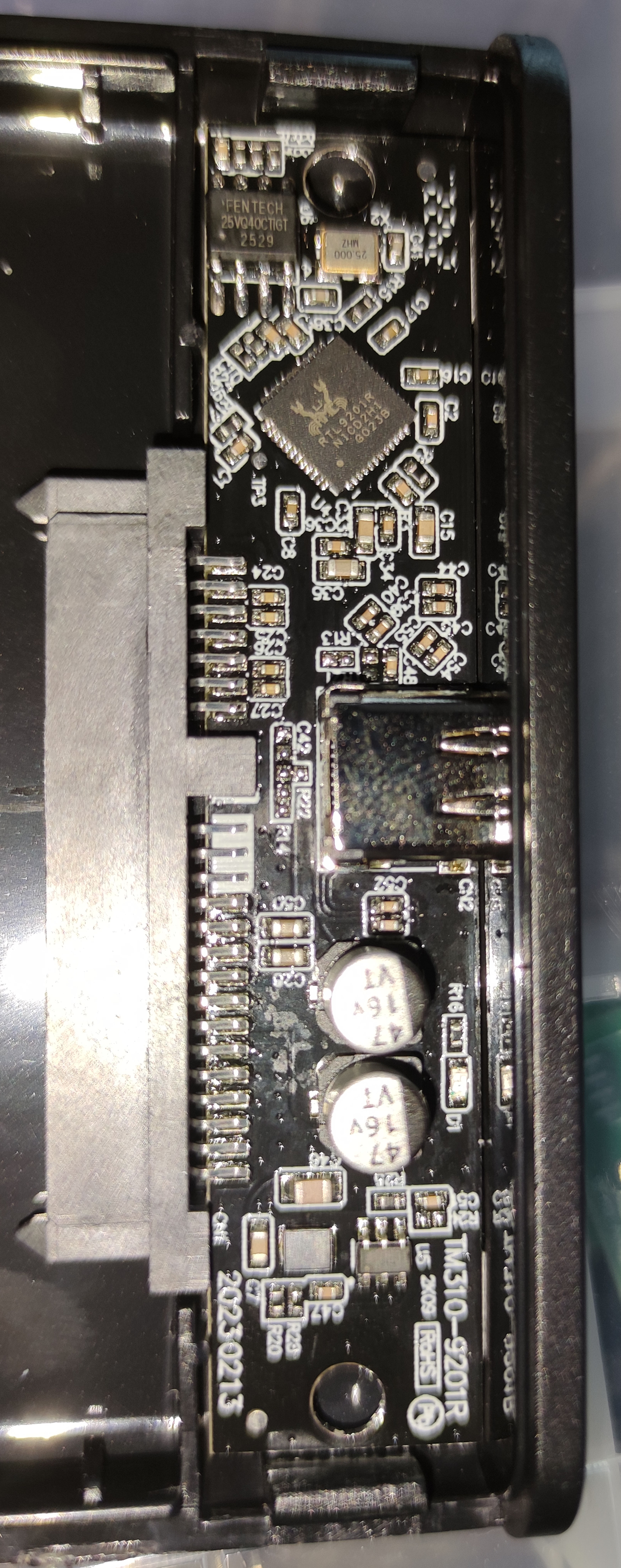

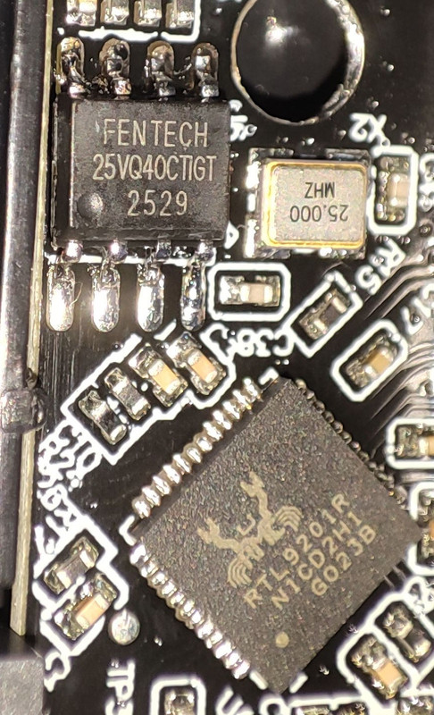

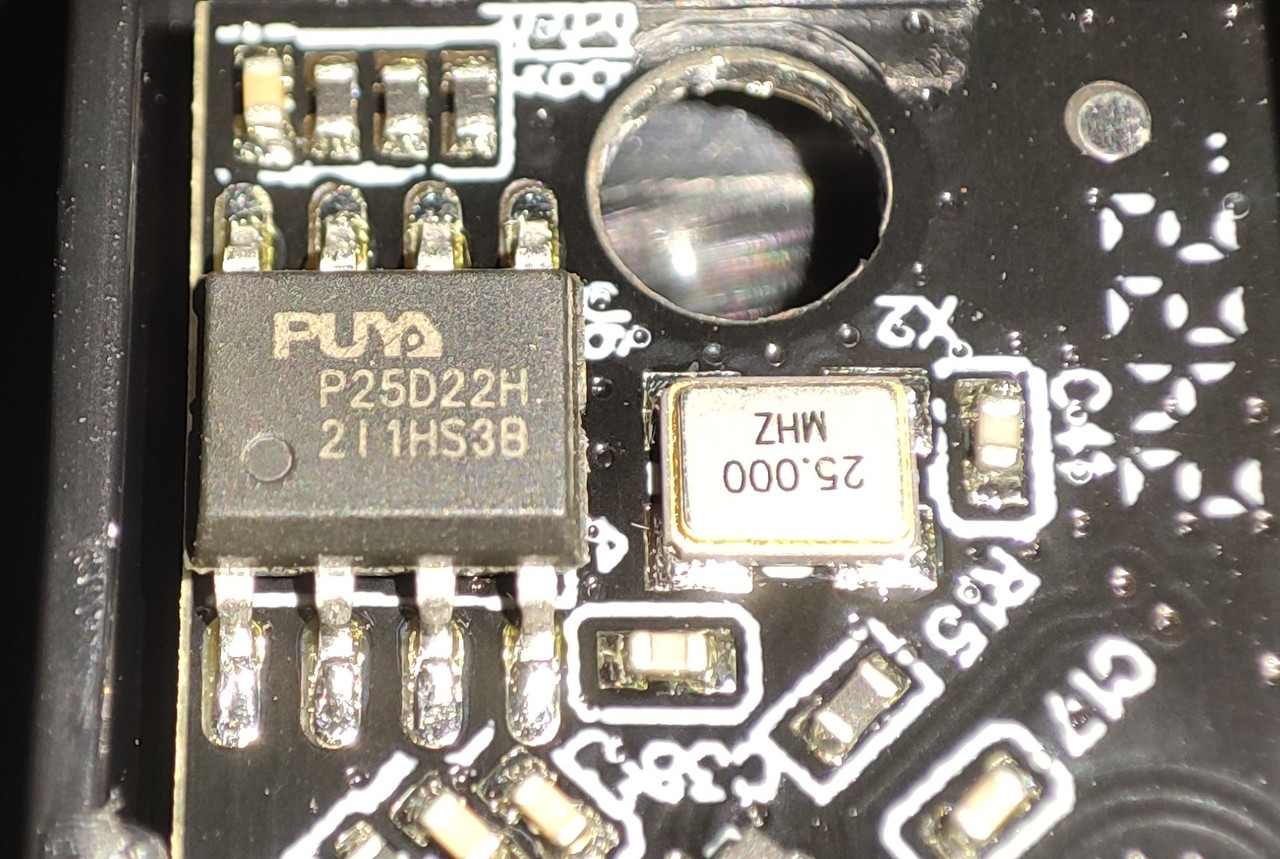

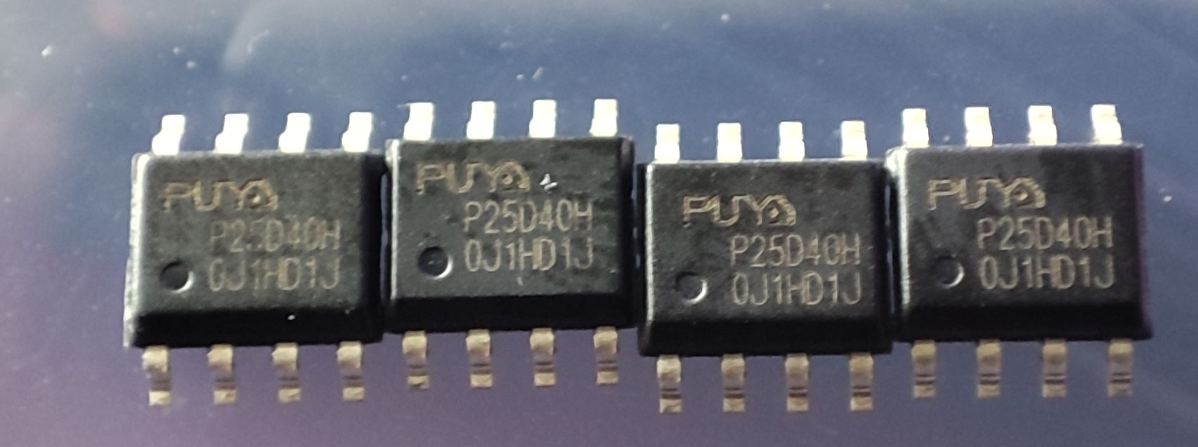

I just replaced a 2Mbit SPI (PUYA P25D22H) on a UTHAI Q7 with a 4Mbit SPI (FENTECH 25VQ40)
My Programmer Had a FENTECH That i pulled from a PCB the other week so i just used that instead of one
of my PUYA P25D40H's
I programmed it with a Factory 1.34.29 SPI image before fitting it just to ensure i didnt get any problems
All went fine and you can update it from windows just fine with any version
If the SPI is only 2Mbit the updater will only show 1.32.7 in the pulldown
e.g. you wont be able to select anything newer
UTHAI Q5/Q6/Q7 2Mbit SPI
UTHAI Q7 4Mbit SPI Fitted
PUYA 4Mbit SPI Chips
