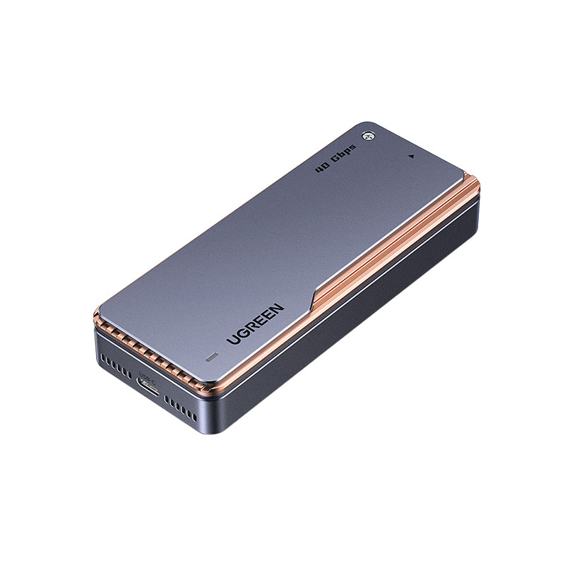

Is there anyone tried the new firmware with this UGreen CM642 enclosure?
I've flashed the new firmware, and the internal fan seems not working now, the enclosure is too hot to hold by hand when plugin over 1 hour. And I can not hear the sound of fan spinning.
How can I get the internal fan working again?

Firmware official

Could you please share this cfg file? or where to find correct one?
And one more question, how to use this cfg file?
Thank you!

firmware AS_USB4_240417_85_00_00 & cfg
