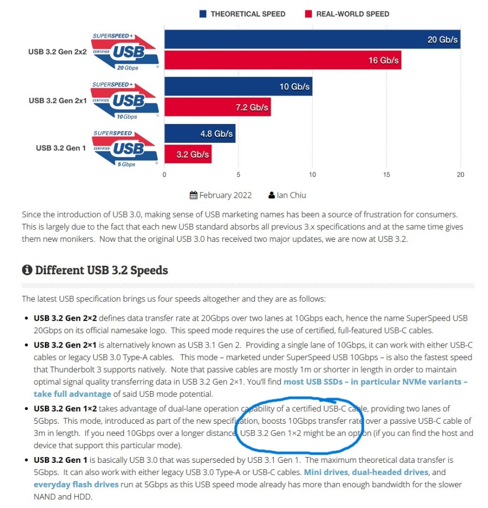

Alien Invader it can work but on the USB-C port but not sure it works in 10Gbps
in USB 3.2. Gen1 this is a bit tricky because not clear on the sites
Quelle est la différence entre USB 3.1 Gen 1, Gen 2 et USB 3.2 ? - Kingston Technology
USB 3.2 Speed Comparison & Real-world Performance (everythingusb.com)

Alien Invader Not easy to know exactly the possibilities of the 3.2 chipset (Gen 1 or Gen 1x1)?
