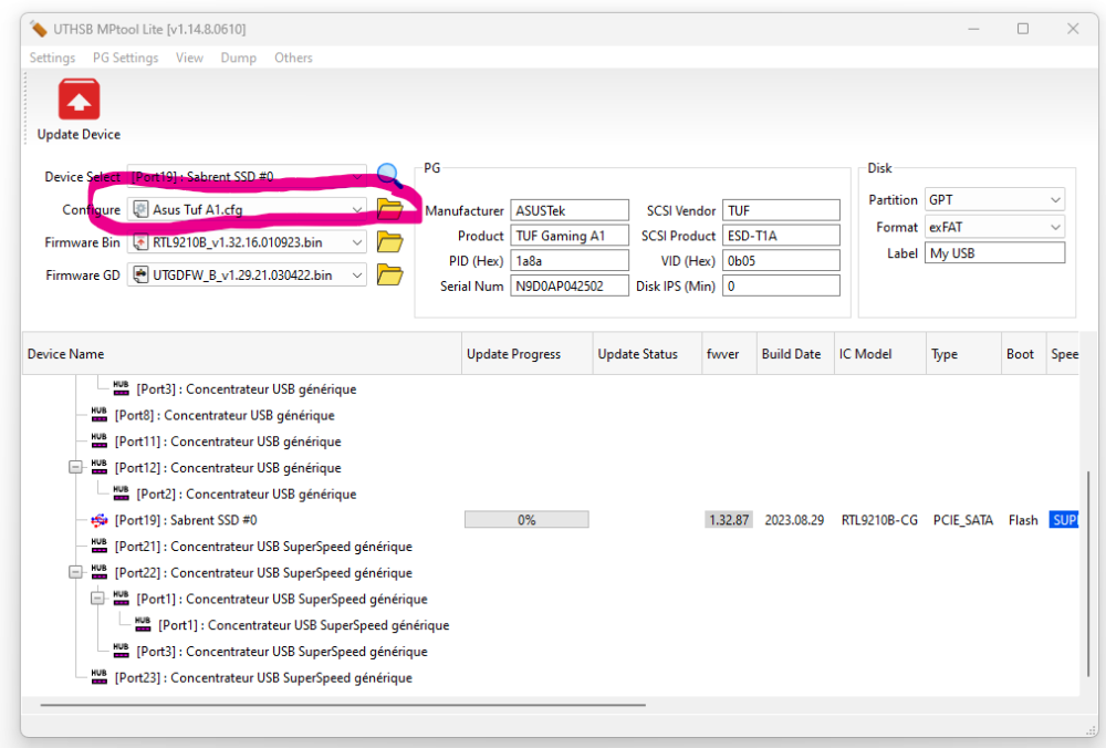

Thanks you as well,
So to clarify, I should edit my dump file as following:
[First line of the config are U2PHY]
U2PHY = n/a
U3PHY = n/a
VID = 0x0b05
PID = 0x1a8a
MANUFACTURE = "ASUSTek"
PRODUCT = "TUF Gaming A1"
SERIAL = "NBD0AP055936"
SCSI_PRODUCT = "ESD-T1A "
SCSI_VENDOR = "TUF "
USB_SELF_PWR = n/a
DISK_HOTPLUG = 0x00
LED = 0x01
PINMUX1 = 0x00000000
PINMUX2 = 0x00000000
U2_MAXPWR = 0xfa
U3_MAXPWR = 0x70
ASPMDIS = 0x00
PCIE_REFCLK = n/a
DISK_IPS_THRES = n/a
SWR_1_2V = n/a
EN_UPS = n/a
PD = n/a
CUSTOMIZED_LED = n/a
SUSPEND_LED_OFF = n/a
FORCE_USB_SPEED = n/a
FORCE_PCIE_SPEED = n/a
EN_U1U2 = n/a
FORCE_USB_QUIRK = n/a
FORCE_PCIE_QUIRK = n/a
FAN = n/a
DIS_SHOW_EMPTY_DISK = n/a
FORCE_SATA_NORMAL_DMA = n/a
UART_DBG_PIN = 0x05
FINGER_PRINT_EN = n/a
RM_INTERNAL_RD = n/a
HS_AUTO_SWITCH = n/a
UART_BAUD_RATE = n/a
CUSTOMIZED_DISK_IDENTIFY = n/a
HW_LED_CFG = 0x80000081
CDROM_CFG = n/a
SUPPORT_HID = n/a
LATE_INIT_DISK = n/a
SCSI_WP_PIN = n/a
SD_MMC_TYPE = n/a
FORCE_PORT_TYPE = n/a
BCDDEVICE = n/a
SUSPEND_DISK_OFF = n/a
SCSI_WB_PIN = n/a
CUSTOMIZED_FEATURE = n/a
PERIPH_API = n/a
RAID_CFG = n/a
Boot Mode = Flash
FW Ver = 1.29.391
FW Build Date = 2022.07.28
IC Pkg Type = PCIE/SATA
UUID = n/a
Disconn_ForceUSB2 = false
[End the file with Disconn line]
like this right? and save it like dump.cfg and select dump.cfg as a configure in mptool?
so if it like this, it's not gonna break my a1 during update right?
also if it does have problem how can I revert it back without using the pin 1 and 8 technique?

Ok take the firmware pack then the configuration file and select it in the update utility as below
Firmware Realtek RTL9210
Fils Config Asus A1
Fils Config Asus A1
