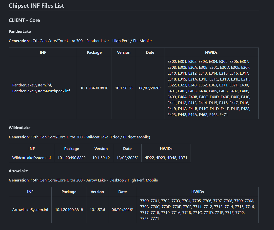

UPDATE
Universal Intel Chipset Device Updater now supports Wildcat Lake platforms !
WildcatLakeSystem.inf version 10.1.59.12 from Intel Chipset Device Software 10.1.20524.8822.
%PCI\VEN_8086&DEV_4D22Desc%=Needs_NO_DRV,PCI\VEN_8086&DEV_4D22
%PCI\VEN_8086&DEV_4D23Desc%=Needs_NO_DRV,PCI\VEN_8086&DEV_4D23
%PCI\VEN_8086&DEV_4D71Desc%=Needs_NO_DRV,PCI\VEN_8086&DEV_4D71
%PCI\VEN_8086&DEV_4D48&SUBSYS_FF008086Desc%=Needs_NO_DRV,PCI\VEN_8086&DEV_4D48&SUBSYS_FF008086

Release: v2026.07.0015
🆕 What's New
EOL Device Support
Multi-Signature Verification
Full Changelog: here
v2026.07.0015 - Fixed handling of EOL (End-Of-Life) chipset platforms.
Previously, HWIDs marked as EOL in the database (dropped from the latest INF package) were skipped, since $uniquePlatforms was keyed by platform name only. Now each platform can carry two independent package entries - "Platform::EOLPackage" and "Platform::MainPackage" - tracked separately via IsEOL flag parsed from the database (#### Platform EOL header or legacy "(EOL...)" marker in the Package column). Install order changed from descending to ascending by package version, so the EOL (older) installer runs first, followed by the current/main installer for the same platform. Devices whose HWID only exists in the EOL package receive the latest INF version available for that specific device; devices covered by the main package receive the newest INF for the whole platform. Verified on X79: no reboot required between the two installer runs, and the newer installer does not remove or override INF entries for HWIDs it no longer lists.
Simplified (using plain language):
The updater now correctly handles individual EOL (End-Of-Life) devices within an otherwise supported chipset platform. Previously, if a single device was marked EOL while the rest of the platform was still supported, that device got skipped. (Platforms fully EOL, e.g. X79, were already supported.) Now the updater installs the last available INF for that specific EOL device first, then installs the newest INF for the rest of the platform - so every device ends up with the best INF version actually available for it.
RaptorLake A77D (EOL) Example:
At this point, the project works flawlessly - the only remaining task is updating the INF database.
Someone "went wild" with AI and generated a nice GUI for my updater, but I'm not sure it makes sense to complicate a tool that already works well. A GUI would significantly bloat the whole application, and you could forget about the 0.7MB size for SFX file, or 0.1MB for PS1 script.
