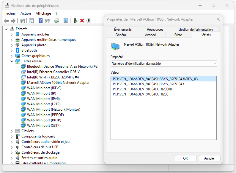

2 года 6 мес. назад - 2 года 6 мес. назадI think there is a detection problem because it shows me this just after launching
Weird weird before it worked well I wonder if it doesn't come from Windows with an update

i would try a bootable windows to go on hiren cd
install the Marvell driver then try it
I suspect windows 11/VBS

me too, I post the new firmware
