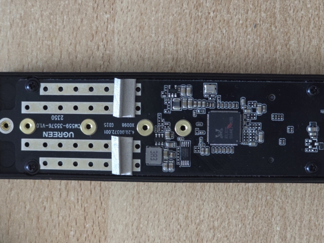

Hello guys, I have a Ugreen enclosure with RTL9220 chip, when I tried to firmware update it, I bricked it so Windows stopped recognizing it. I opened the case and used tweezers and tried to unbrick it, when I connect certain pins with tweezer, Windows sees it as USB-Drive and on device manager I see RTL9220 but it is unusable (it just shows on explorer but cant do anything and after few seconds it unplugs automatically. Does anyone knows how to reset it so I can firmware it again and make it work?

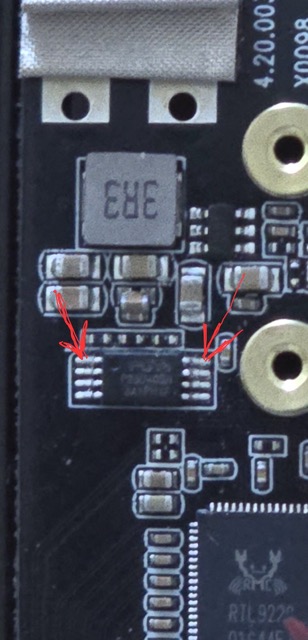

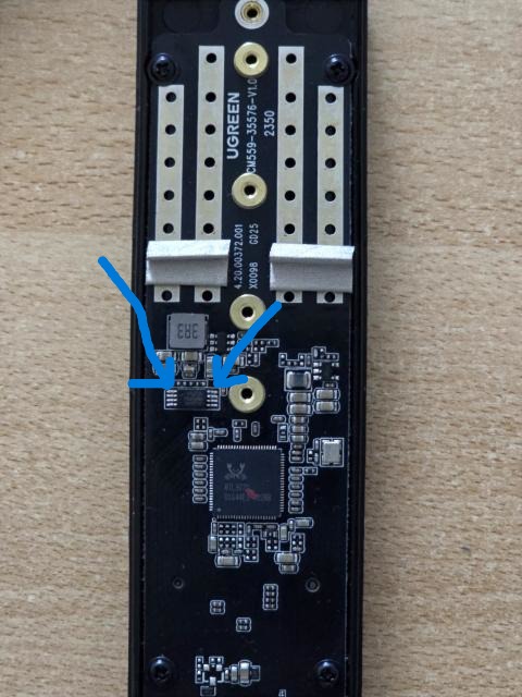

Where should I put my tweezers in this picture?

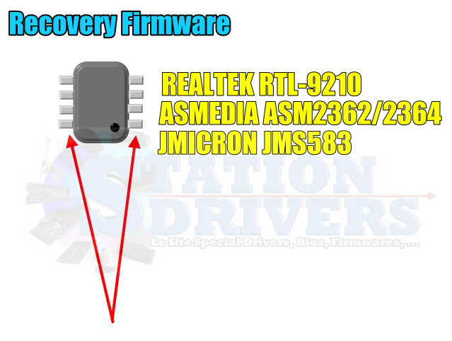

Carefully check that the marker is at the top, then, while maintaining the short circuit, wait for the box to appear via MPTool, then release.

Oh...this is how I tried to do. Once I touch these 2 pins with tweezer, I hear the sound on my PC that something got connected, I see the drive as USB-Drive (also in Device manager under Disks it says RTL9220), but I cant see it on MPTool and it also automatically gets disconnected and I have to remove and put the cable back to PC.

you just have to hold the tweezers on until you hear windows detect it
to stop it booting from that chip
once its booted you have to remove the tweezers so its detectable so you can flash it
