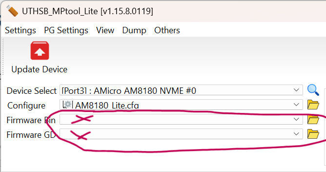

@sdefrwggerg
Could you please reupload the configs files folder? I desperately need the AM8180 config file.
If someone else has it, please share it!

@JimmieDamn Here is the file your wanting download it from the link.
[url] www.sendspace.com/file/eetjfv [/url]

@Laroldski
Ok thank you very much.
Now when I select that config file that you uploaded, the uthsb tool lite doesn't select the firmware bin and GD. I'm trying to flash the latest v1.33.44 driver, but it doesn't select the files when I try to flash to the Lemorele AM8180 enclosure. I've tried renaming the firmwares with "AM8180" but no luck. How should I modifiy the bin files so that I can select them?
