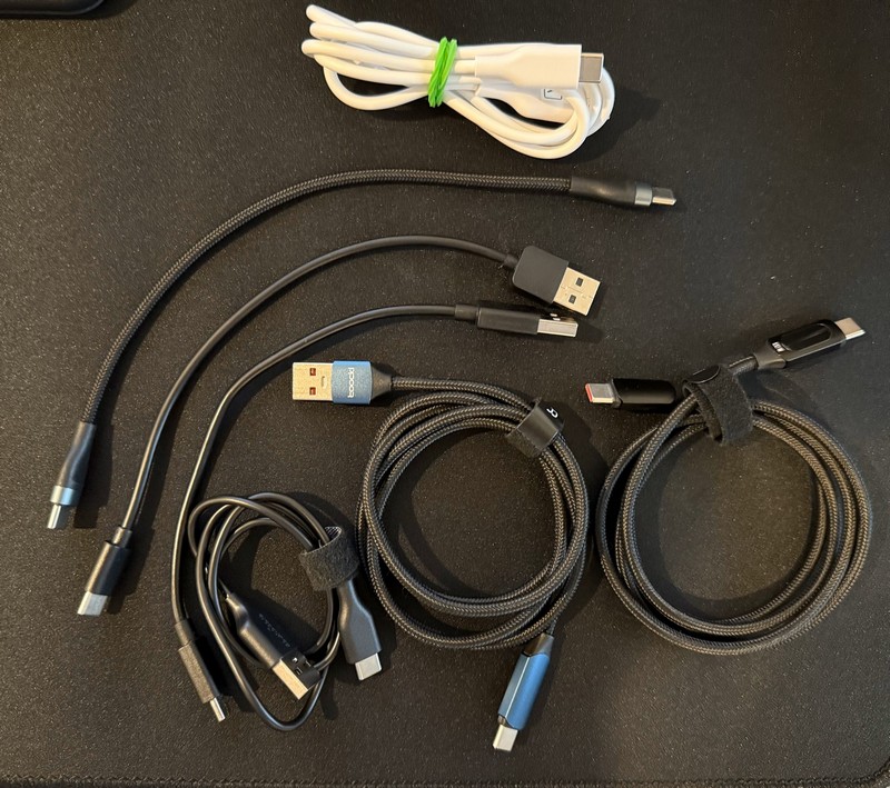

After receiving my new enclosures (JMS583) today, and they also ran at USB 2.0 speeds, I was able to figure out the problem.
I had another two cables--one really bent and twisted one that came with the new enclosure, and another really short and thick one. These connected the new enclosures AS WELL AS MY ORICO ENCLOSURE at the correct speeds, reported as: USB 3.2 Gen 2 SuperSpeedPlus.

Hi thanks for the information yes it is important to choose the right cable

it is true that certain USB 3.2 ports pose problems, always check if there is firmware that corrects the transfer problems and I repeat, have a good USB 3.2 cable or more (eg: Thunderbolt or USB 4 certified) and the shortest possible
