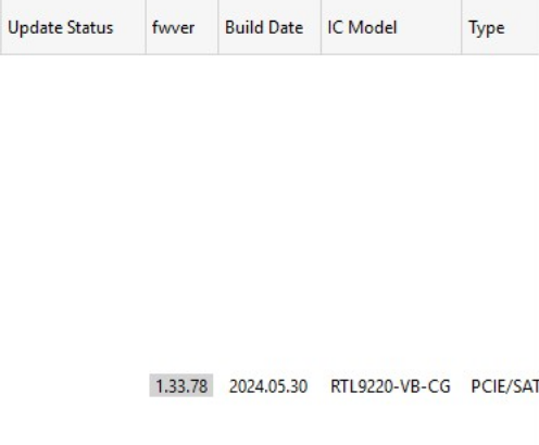

Here it is in dump, thank you very much
Device : [Port17] : KINGSTON SFYRD2000G #0
U2PHY : n/a
U3PHY : n/a
PID : 0x9220
MANUFACTURE : "Ugreen"
PRODUCT : "Ugreen Storage Device"
SERIAL : "133890720580"
SCSI_PRODUCT : "n/a"
SCSI_VENDOR : "n/a"
USB_SELF_PWR : n/a
DISK_HOTPLUG : 0x01
LED : 0x03
PINMUX1 : n/a
PINMUX2 : n/a
U2_MAXPWR : n/a
U3_MAXPWR : n/a
ASPMDIS : n/a
DISK_IPS_THRES : 0x0f
CUSTOMIZED_LED : 42 00 02 00 00 00 00 00 00 00 00 00 00 00 00
DIS_SHOW_EMPTY_DISK : 0x01
UART_DBG_PIN : 0x64
SUPPORT_HID : 0x00000005
SUSPEND_DISK_OFF : n/a
CUSTOMIZED_FEATURE : n/a
PERIPH_API : n/a
RAID_CFG : n/a
FW Ver : 1.33.89
FW Build Date : 2024.07.26
IC Pkg Type : PCIE/SATA SD
Disconn_ForceUSB2 : false

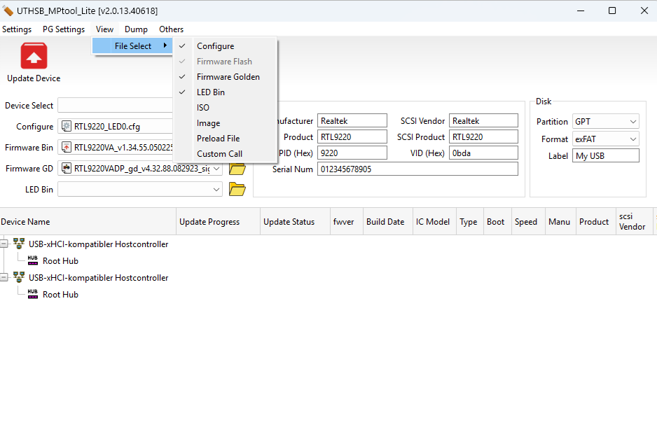

1 år 2 månader sedan - 1 år 2 månader sedanCode:
;Configure Start
PID : 0x9220
DISK_HOTPLUG : 0x01
LED : 0x03
UART_DBG_PIN : 0x64
;DISCONN_FORCE_USB2 = n
;FORMAT_DISK = n
;INC_SERIAL = y
;PARTITION: GPT, MBR PARTITION = "MBR"
;FORMAT: NTFS, exFAT FORMAT = "NTFS"
;LABEL max allowed - characters LABEL = "My USB"
name it RTL9220_VB_Ugreen.cfg for B Version
RTL9220_VA_Ugreen.cfg for A Version
The version number looks very peculiar Version 9.34.55 and not v 1.34.55 It is only for 9220A and two GDFW
GDFW_9220VA Version: 4.32.88.082923
GDFW_9220VADP Version: 4.32.88.082923
On your first Post its RTL9220_B risk is hight to brik it.
Maybe you also need a Led.bin file for you RGB

Thank you yes I think so too because after the firmware update the LEDs are no longer active so I think you need the famous led.bin file which is not found
- Inlägg: 45
When the case transmits data, the gradient of the RGB light is automatically generated, which makes for a cool visual experience. This also speaks in favor of programmed lighting control.
PID : 0x9220
DISK_HOTPLUG : 0x01
LED : 0x03
DIS_SHOW_EMPTY_DISK : 0x01UART_DBG_PIN : 0x64
HW_LED_CFG = 0x1
You can try to active Hardware light Profile with ;HW_LED_CFG = 0x1 and without " ; "
Or ask Ugreen for the Firmware. www.ugreen.com/pages/contact-us
