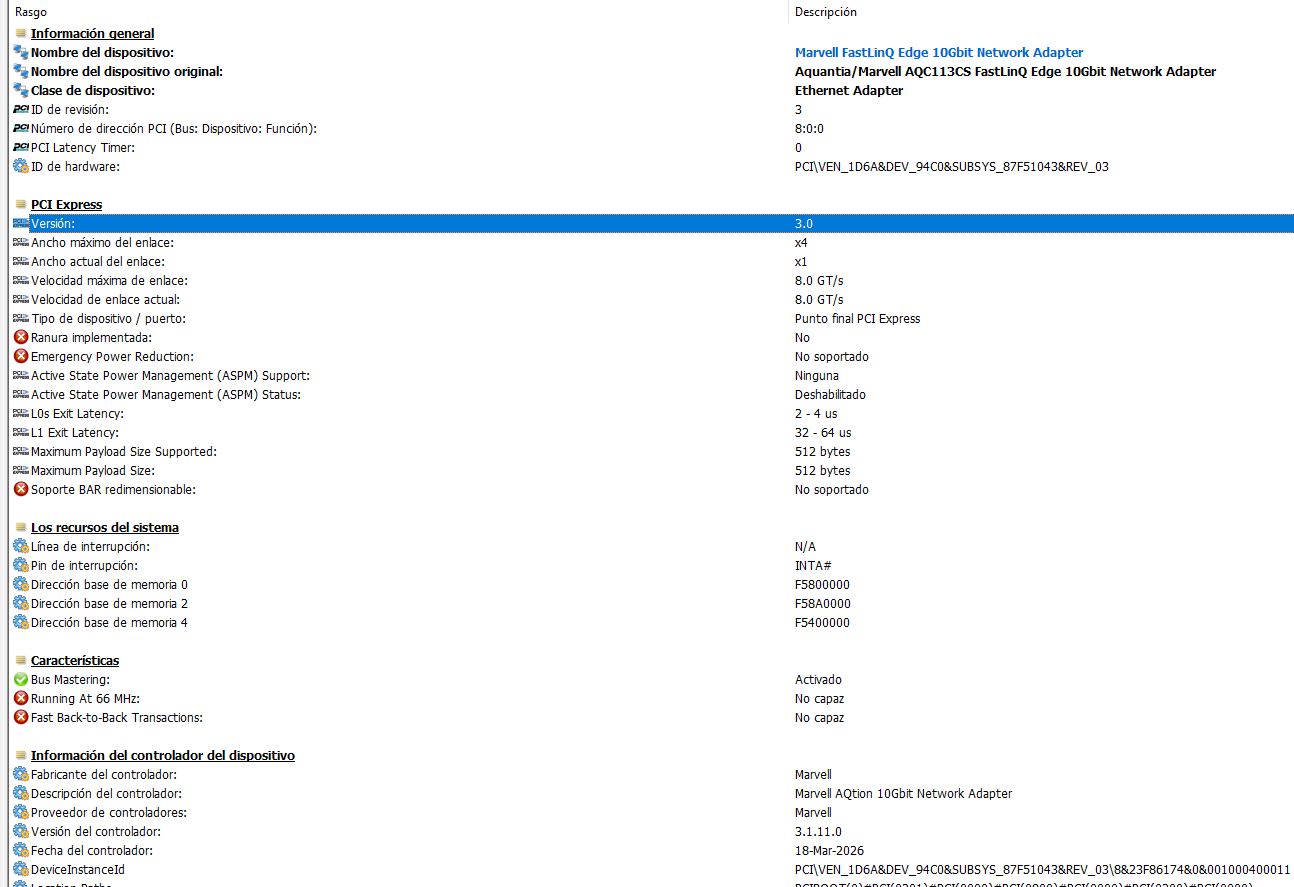

I was able to flash the PS/1 card successfully without modifying the firmware using `--update`. This is on an Asus Proart x670-E motherboard. It's working correctly so far, and I'm on the latest firmware.
My only question is that I understand this adapter is PCI Gen4.
However, HWInfo64 on Gen3,I understand it should be Gen4 x1 Is anyone else experiencing this?

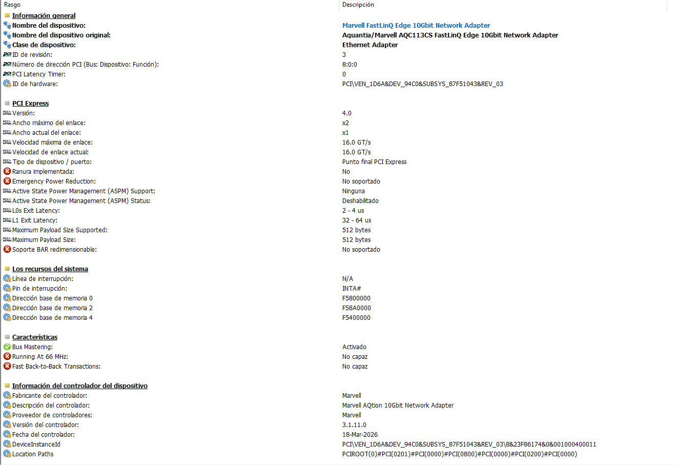

In response to my previous post: it was indeed the firmware.
I reinstalled the firmware at 1.5.39 specifically, this one with Hiren's BootCD AQC113-Asus_Bx-1.5.39_bdp_aqsign.clxand it's back to normal at Gen4 x1.
I hope this information helps someone else, because I couldn't find anything else about it.
