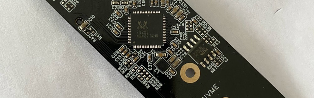

after updating to the latest firmware all ssd are not writeable, any idea how to fix this ?
I used the attached .cfg files...when flashing to higher firmware....
Chipset pic attached, seems to be:
RTL9210 N6AK5E2 GN24B
Nick
RTL9210.cfg:
VID = 0xbda
PID = 0x9210
MANUFACTURE = "Realtek"
SCSI_VENDOR = "Realtek"
PRODUCT = "RTL9210"
SCSI_PRODUCT = "RTL9210"
SERIAL = "802345978984"
DISK_IPS_THRES = 30
LED = 0x1
CUSTOMIZED_LED = 00 00
SUSPEND_DISK_OFF = 0x7
SCSI_WP_PIN = 0xc
UART_DBG_PIN = 5
PERIPH_API = 1
UART_BAUD_RATE = 57600
Nick

write protection switch present 0xa, 0xc
SCSI_WP_PIN = 0x0
SD_MMC_TYPE = 0x0
SCSI_WP_PIN = 0x0
SD_MMC_TYPE = 0x0
