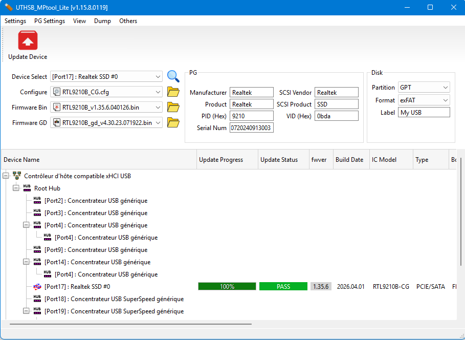

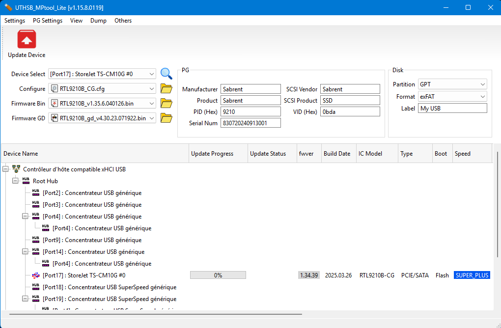

New Firmware Realtek RTL9210(B) NVMe/USB 3.1 Controller firmware Version 1.35.6.040126
www.station-drivers.com/index.php/en/com...6.040126/lang,en-gb/
