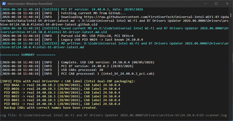

The fix:
I have completely rewritten the scanner that generates the intel-bt-driver-latest.md database (the updater script itself is unchanged). The new scanner (version 4.6) does this:
Example: For AX201 (PID 0026), the updater will now show 24.40.10.3 instead of 24.50.0.4. No more false upgrade prompts.

The fix:
- Downloads each USB CAB
- Extracts the ibtusb.inf file using expand.exe
- Parses the INF to find which DriverVer actually matches each PID (e.g. PID_0026 for AX201)
- Creates per-PID entries in the MD file with the real installed version – not the CAB label
