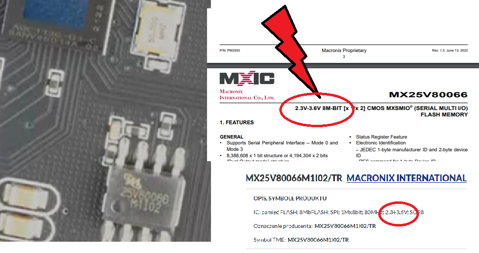

I've read that some of you dumped fimware from the Chinese AQC113 card using CH341A.
I found the video and saw that this card has MX25V80066 memory chip. This chip works with 3,3V.
The CH341A programmer has a bug. The voltage can be changed by a jumper to 3,3V but on all data lines there are still 5V!
Without a simple fix of the programmer, using it for 3,3V chips can quickly destroy them. Futhermore, the dump usually contains corrupted data. MX chips are vulnerable for the higher voltage. Only first few times the chip can resist higher voltage and reads the dump correct. If you dumped the firmware only few times using the unfixed CH341A, never do it again, Find the manual in the Internet and fix your programmer in 5 minutes.
BTW. These chip from the Chinese card is 8Mbit size (1MB). I thought that Aquantia uses 32Mbit memory (4MB). AQC107 does. Am I missing something?
