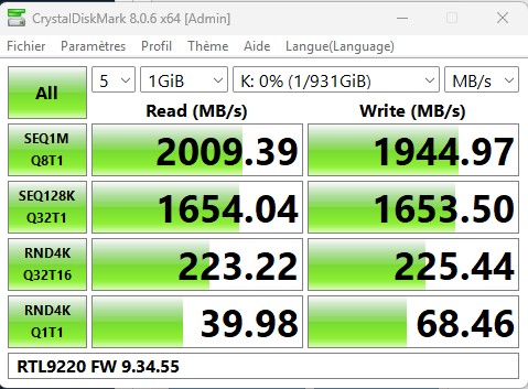

Finally, a firmware that solves my throughput issues on my RTL9220 enclosures, which have been mediocre from the start.
This is the first time I've seen a firmware that boosts the performance of my external drives.

Please feel free to leave a comment if you notice any improvement.
Download Firmware Version 9.34.55

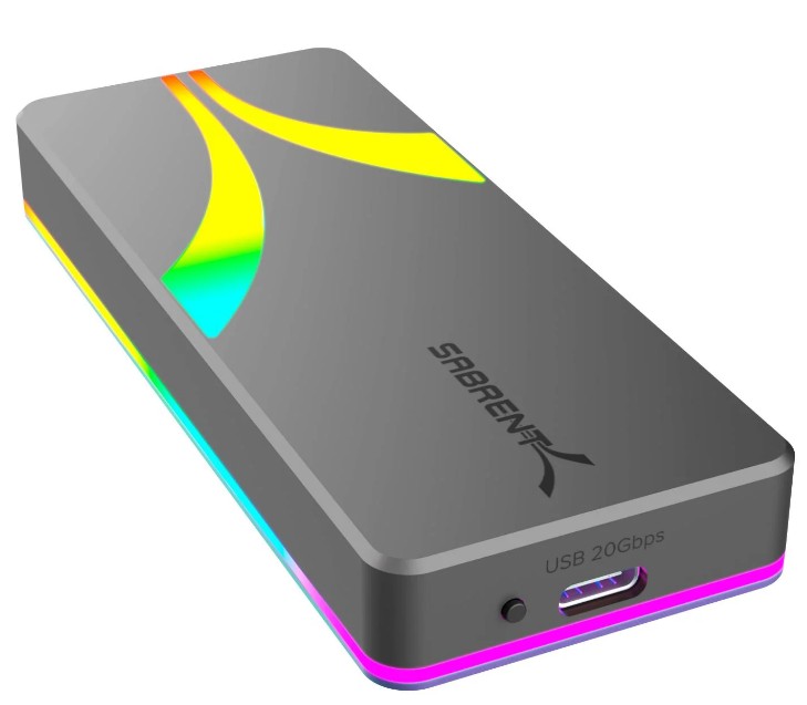

1 year 2 months agoHi everyone, I'm looking for a way to recover the *.bin firmware that allows the box to illuminate the LEDs because otherwise after a firmware update, I automatically lose the LED lighting part of the box.

Thank you very much, I tried but it erases the CFG file and is there a need for a *.bin file for the LED strips?
