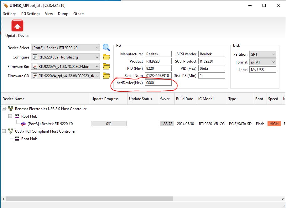

@TheGiolly I tried doing what you said but the new file I made just made my enclosure's board fail and I had to do a reset by shorting the 2 pin's in the one chip,can you take a look at the original .cfg file and the one I made and tell me if there is something you can see.

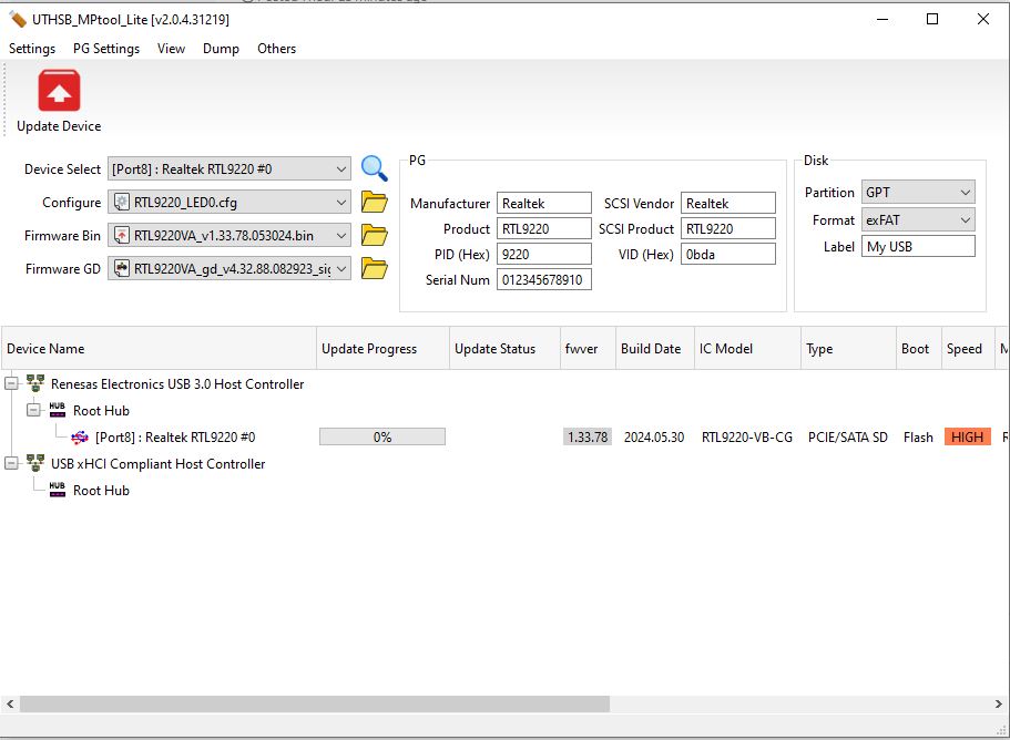

Also if you look at the first picture I have used the included RTL9220_LED0.cfg file and it works fine with my enclosure and the enclosure works in everyway the way it should,but if I try and use the the setting's from the original dump file I get a new box in the firmware tool that I circled in red and the box say's bcdDevice(Hex)

[img][img]https://i.imgur.com/DtoYvcf.jpg[/img][/img]

2 년 1 월 전The firmware only works on the RTL9220VA chipset, I don't know if yourIs is the RTL9220A or others.
From what I'm seeing with mine it's a RTL9220-VB-CG,if I use the included RTL9220_LED0.cfg file and my enclosure fine with no problems at all but if I try and use my back dump file it fails every time and I have to short the 2 pins and reset.
The first picture is the showing the firmware version and was never flashed yetand the firmware version is v132.82,the second picture shows it flashed with the new v133.78

@TheGiolly that did work it just failed again,I don't know if you looked at the picture put up for admin to look at but you can see circled in red it say's bcdDevice(Hex)there is also something that say's Disk IPS(Min)1 in the screen shot I took that isn't in the original .cfg file and I delete those lines as well and the box's went away for them as well and that still didn't help.
