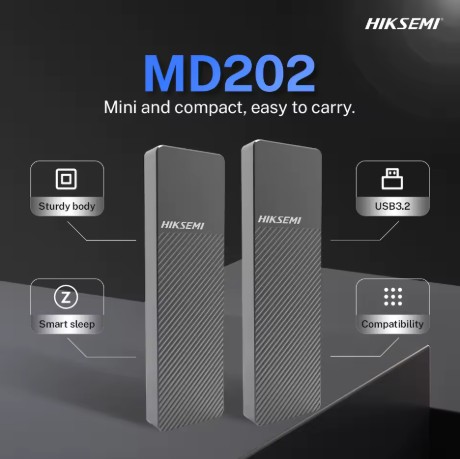

@admin I thought I would ask you this and if you don't know maybe someone else will know why this is.
I have noticed that the RTL9210 chip has a really stupid quirk and that is if you use the Dump file method of trying to create your own backup copy of your configure file if you can't find the factory configure file for your enclosure.
I have a Hiksemi enclosure and I find I have to use configure file RTL9210B_CG_LED0.CFG which is the only one that works fine with that enclosure,I have also tried HIKSEMI_MD202.cfg but the led doesn't work at all with that configure file.
Here is my main point to this thread however,after I flash the enclosure with new firmware and use RTL9210B_CG_LED0.CFG and then check the Dump file they never for whatever the reason.
The stupidest part of it all is that you would think the firmware tool would make a clone of whatever it see's in the enclosure as far as the setting's go when you use the Dump file method which makes no sense at all.
This is the information on the RTL9210B_CG_LED0.CFG file.

This is what the Dump file say's after flashing the enclosure.
