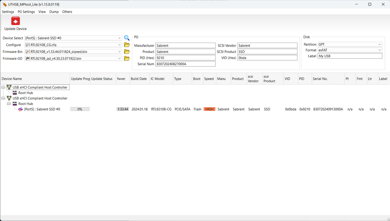

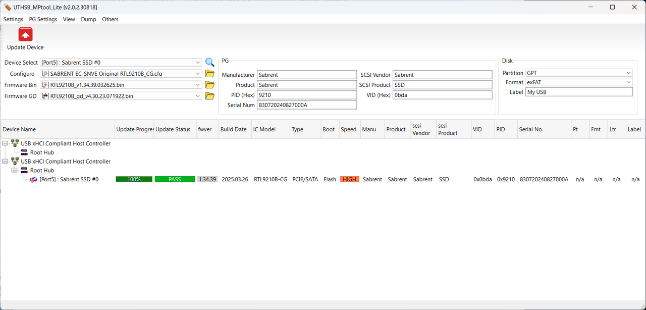

My question is as a first time new SSD enclosure user with the SABRENT EC-SNVE which is Realtek RTL9210B-CG based, does anyone know if this or other RL9210B-CG based enclosures allow Samsung Magician to detect the SSD so Samsung's own SSD can be updated as I know in Device Manager, the drive shows up as Sabrent SSD SCSI Disk Device and Magician seems to see my Toshiba 1TB SSD currently inside the notebook but not the enclosure or the SSD in it.  Thanks!
