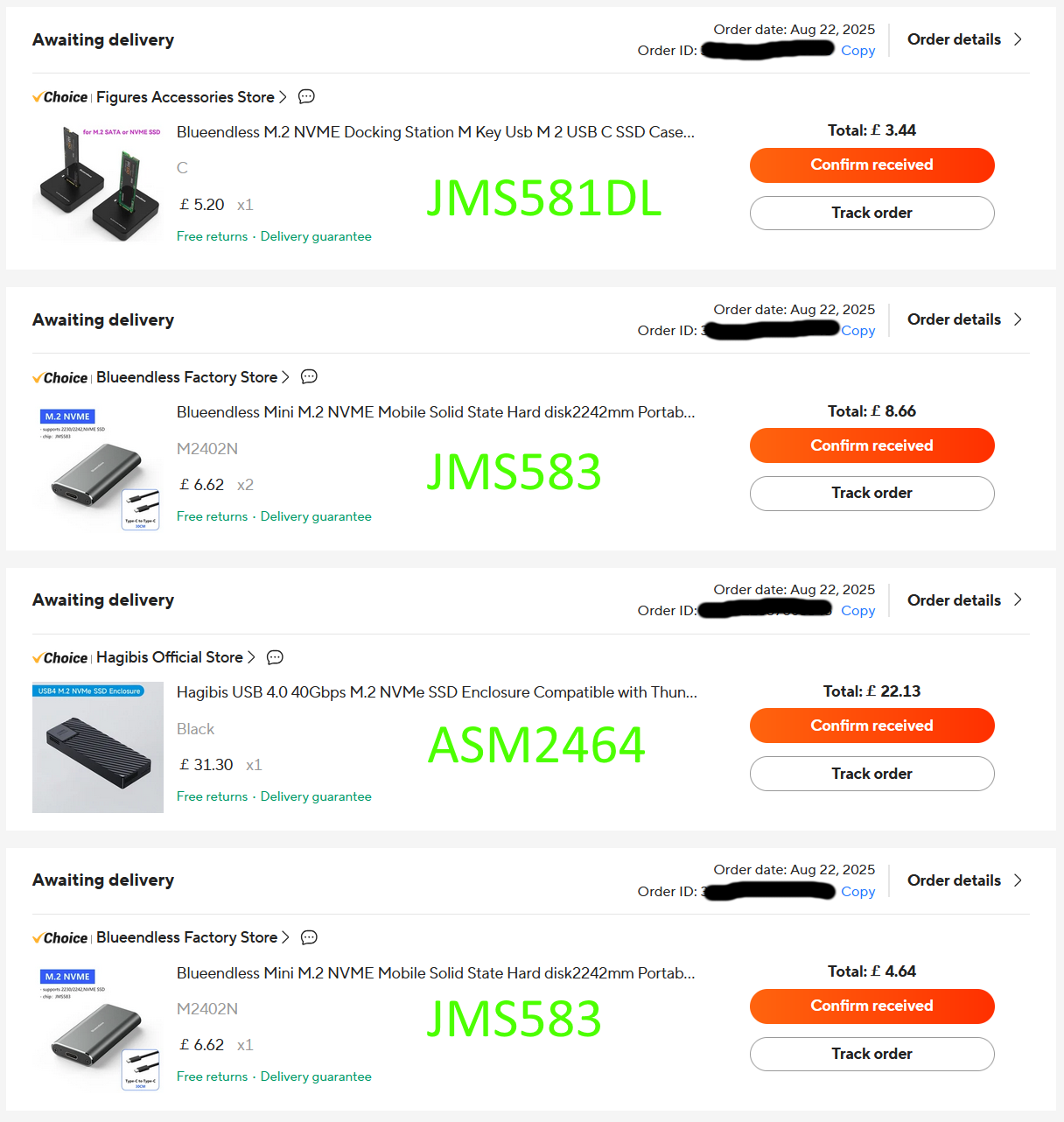

I have had the one above for about a year
I have another one coming it was going super cheap
If it turns up with newer firmware i will edit this post with the updated firmware
edit
nope was same firmware
