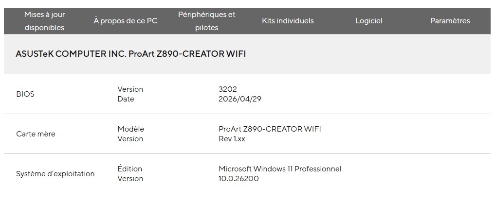

Hi, yes, I have the Z890 ProArt—it's a really good motherboard. As for ASPM, I haven't checked, but my PC gives me fewer issues with sleep mode now; it goes into sleep mode without any problems.
