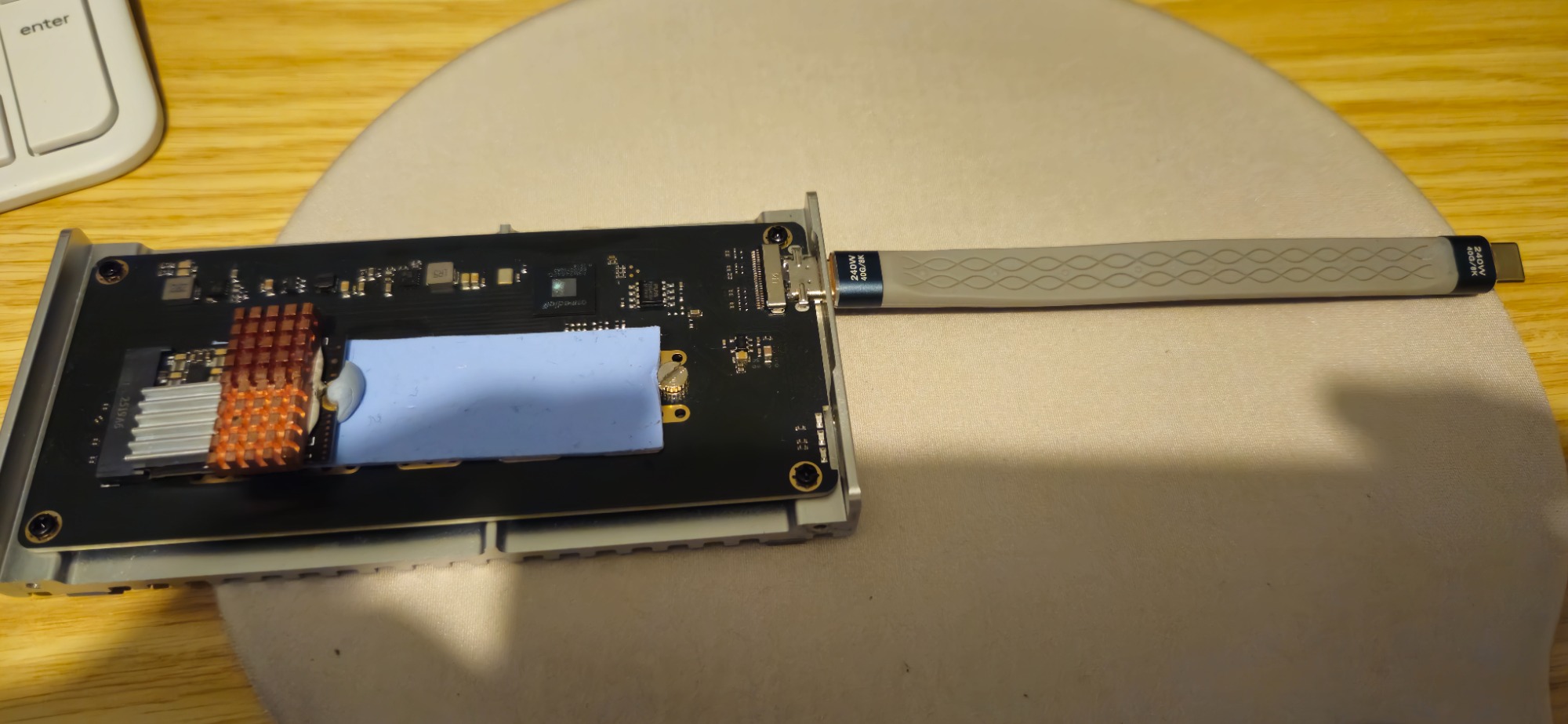

I found the 20 or 30cm cable that came with my enclosure
that is supposed to work at 40gbps didnt work on my 11950H
gen2x2 instead of gen3x2
ended up using 10cm flat cables it operates at 40gbps now (gen3x2)
so no havnt tried any longer ones

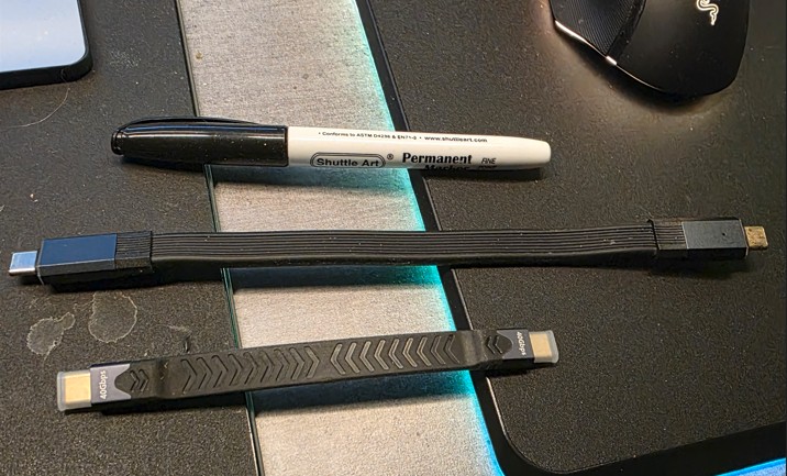

This could also be due to the disk not being recognized; it happens, hence the importance of updating the firmware regularly. As Shonk rightly said, I have a 10cm cable and it works perfectly.

I have my 13cm cable that cost £1.99 from aliexpress which works perfectly fine at 40gbps transfers, its anything above that fails (0.3, 0.5, 1metre+)
This one here works fine:
Maybe USB 4/Thunderbolt 4 devices only like 10-13cm cables?
I think ill try 1-2 certified thunderbolt 4 0.3 cables, after that its probably powered thunderbolt 4 docks/hubs that's required
