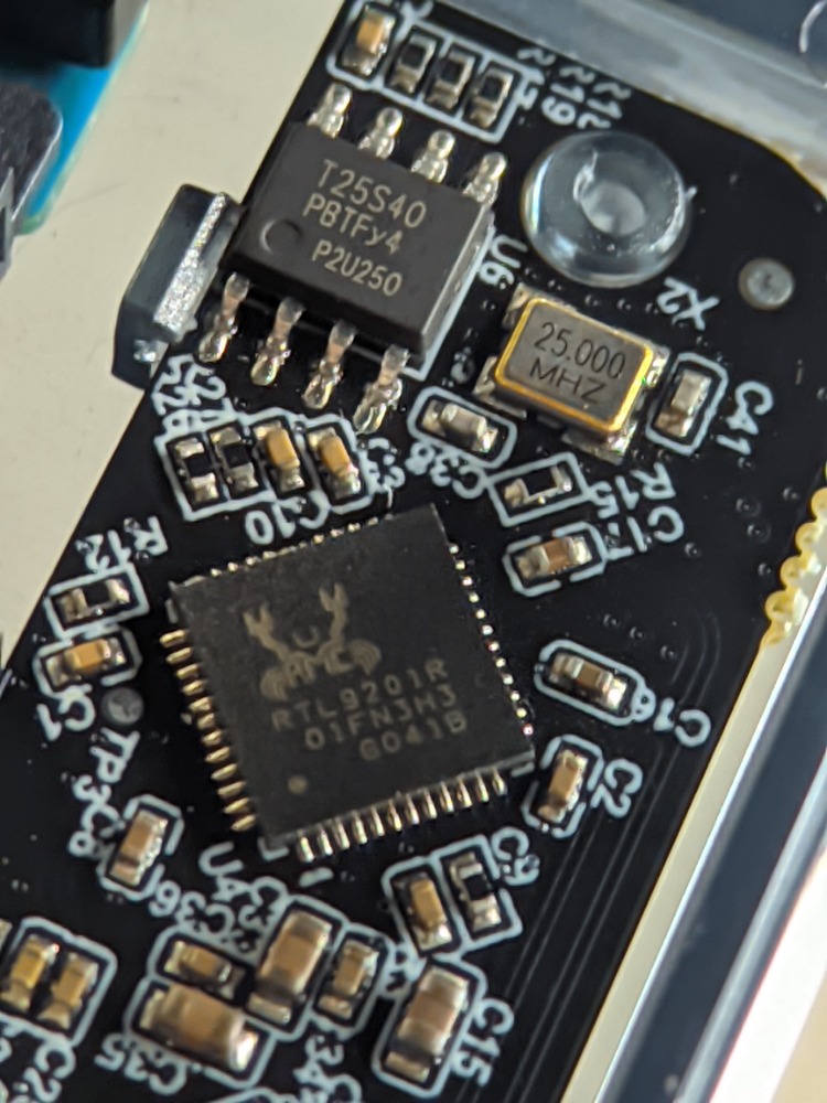

I did not unsolder the chip. First I made one dump of the box with a color screen with NeoProgrammer, the second dump I made with AsProgrammer. Both dumps were identical. With this dump I successfully flashed the box with a monochrome screen.
NeoProgrammer identifies memory in a case with a color screen as FT25H04, in a case with a monochrome screen as ZB25WD40.
In AsProgrammer I chose N25S40 Nantronics.
Before that I broke the smart information output on the case with a monochrome screen by flashing 1.32.7 firmware.
Apparently this firmware does not support the output of such information. Then I flashed your Cofre Disco Duro 1.33.88 SPI dump. This firmware is newer but does not have PERIPH_API = 0x01 in the configuration responsible for RTL9201R communication with an additional controller for display on the screen.
The original firmware in the case with a monochrome screen was 1.32.62

Recently, I bought an USB-C Enclosure from AliExpress. Brand is Eaget. The issue is that I've noticed that, after a while, maybe a minute or 2, the HDD would kinda 'sleep'. I noticed that on windows, it won't disconnect. But after this time passes, it takes a while to create a new folder or access any file on the HDD. This has been a problem 'cause I'm trying to use the drive and it's really annoying me haha. the chip seems to be RTL9201R. Can you guys help me? I'm a newbie. I've downloaded MPtool_lite and got to this DUMP section which showed me this:
Can I disable this timer the Case seems to have?
