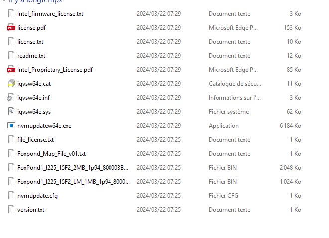

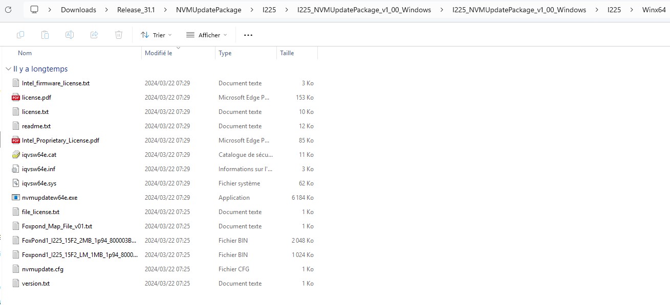

Thank you very much! How to check the LAN firmware version? Any help on the flash? There are different bin and no executable file.

Hi, download the latest Intel Network Pack; the necessary files are in the NVM directory.
Intel Nework 31.1
www.station-drivers.com/index.php/en/com...ion-31.1/lang,en-gb/
Alternatively, run the command `nvmupdatew64e.exe -i -l inventory.txt`.
To update, simply change the firmware of the NVM directory in the Intel network pack and replace it with the one you want.
Intel Nework 31.1
