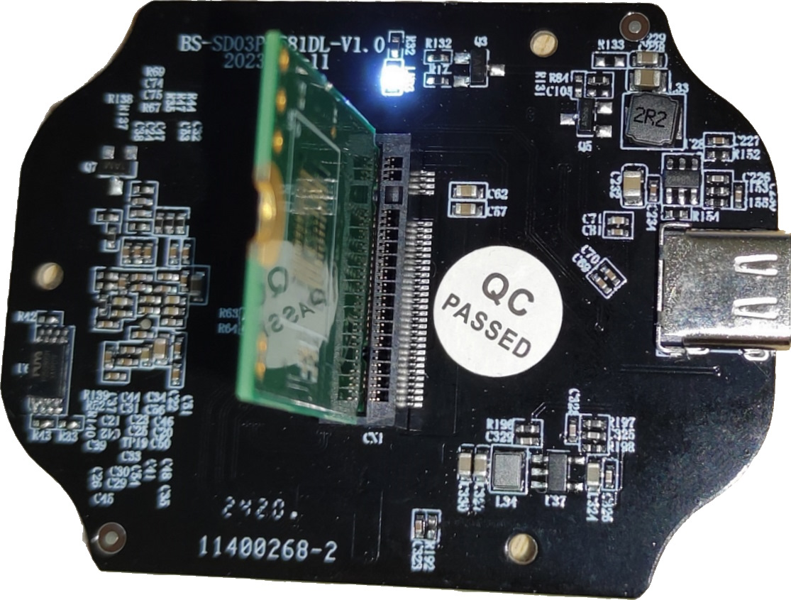

- Inlägg: 4
Re: JMicron JMS581 NVMe/SATA USB 3.2 10Gbps Controller Firmware Version 04.01.00.04
1 år 1 månad sedan
Hello, my hard drive enclosure and firmware are exactly the same as yours. The current status is as shown in the picture.
I can try adding the NVRAM, but the firmware update tool no longer recognizes the device, and on the computer, it only shows up as a mass storage device, with a message saying "This device cannot start." Do I need to use a programmer for this?
