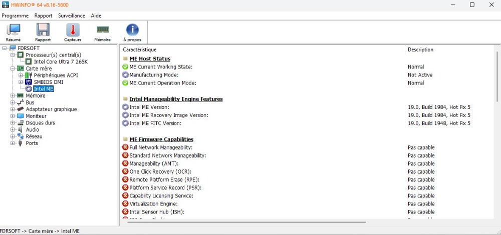

Release note: Intel has identified security issue that could potentially place impacted platform at risk.
Intel Management Engine (ME) Firmware Version 19.0.5.1984 (S&H 1.5Mo)
Check your vulnerability with the Intel utility below which allows you to check if you have the latest Management Engine (ME) firmware and if you are vulnerable
Last edit: 1 år 5 månader sedan by admin.

There are two versions, either T or S.
Mine is T.
If in doubt, wait for the official version of your motherboard.
Mine is T.
