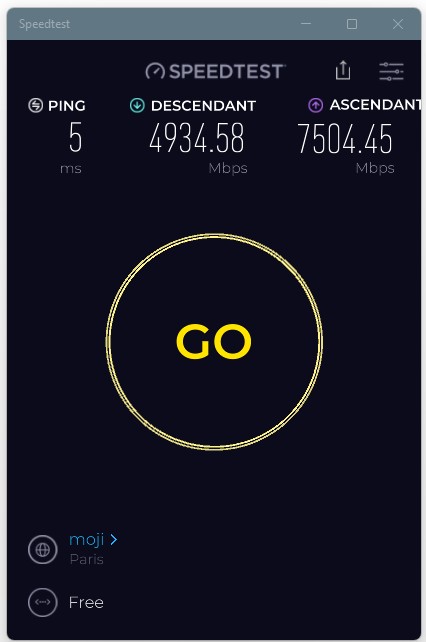

1st fast test on my IOCREST 10GB TB3 connected on USB4 on my Asus X870E Crosshair Hero.
It seems to be stable. I will try a bit more tomorrow because with previous drivers i've some packets loss on some games like Valorant and disconnections when i download with Steam.

I'm also experiencing no network problems on the internet or with data transfers to my NAS so far.
(NAS Ugreen)
