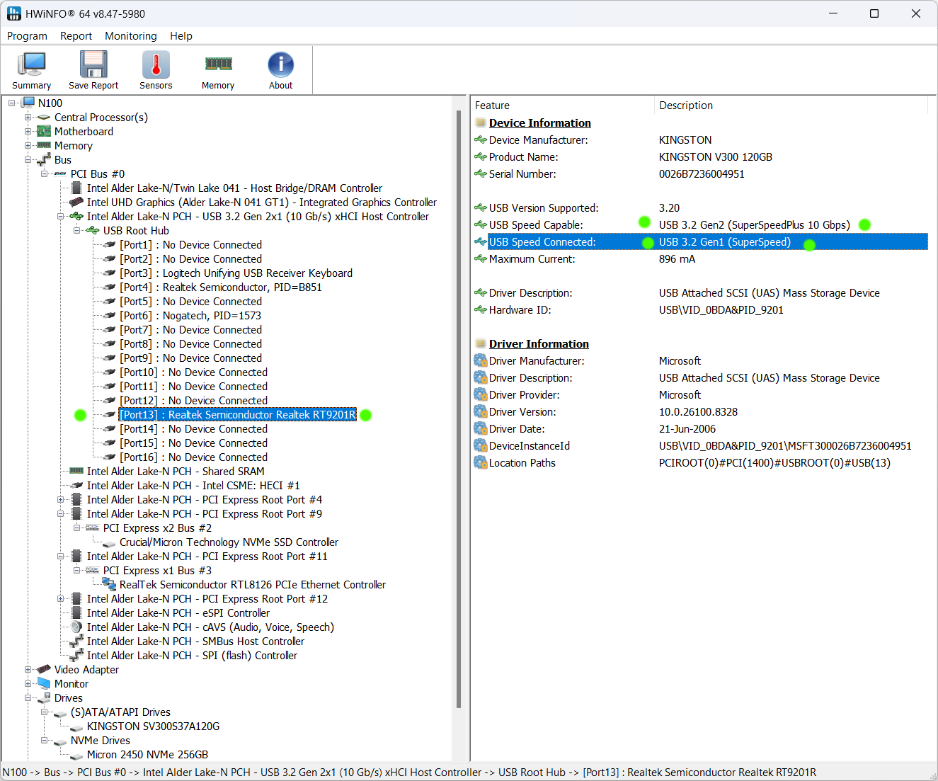

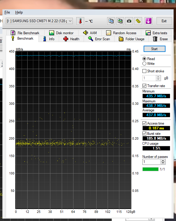

Oh btw the RTL9201R reports that it is USB 3.2 Gen2 but is hardware Capped at USB 3.2 Gen1 via some sort of hardware level lockout
so its Speed is capped at SATA of around 439 MB/s
By the looks of it the RTL9201 non R is allowed to link at USB 3.2 Gen2 to allow the full speed of around 535 MB/s
