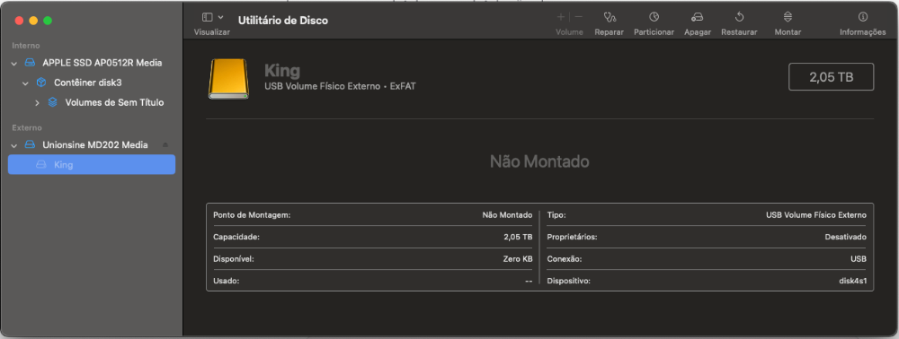

I updated my Unionsine MD202 with Realtek RTL9210B chipset firmware Version 1.32.49.140423, but macos won't mount the nvme drive. Could someone help me please.
The configuration is like this.
;Configure Start
U2PHY = 02 f4 9b e0 e1
U3PHY = 02 d4 09 00 d5 00 80
VID = 0xbda
PID = 0x9210
MANUFACTURE = "Unionsine"
SCSI_VENDOR = " "
PRODUCT = "MD202"
SERIAL = "N9D0AP042502"
DISK_HOTPLUG = 0x0
LED = 0x2
PINMUX1 = 0x0
PINMUX2 = 0x0
U2_MAXPWR = 0xfa
U3_MAXPWR = 0x0
ASPMDIS = 0x0
DISK_IPS_THRES = false
;EN_UPS = n/a
;PD = n/a
HW_LED_CFG = false
CUSTOMIZED_LED = 07 00
SUSPEND_LED_OFF = 0x0
FAN = false
DIS_SHOW_EMPTY_DISK = false
FORCE_SATA_NORMAL_DMA = false
UART_DBG_PIN = 0x5
FINGER_PRINT_EN = false
DISCONN_FORCE_USB2 = 0x0
FORMAT_DISK = n
INC_SERIAL = false
;PARTITION: GPT, MBR
PARTITION = "GPT"
;FORMAT: NTFS, exFAT
FORMAT = "exFAT"
LABEL = "My USB"

Yes, if I use the default configuration of realtek the files are in read mode, not allowing writing.
