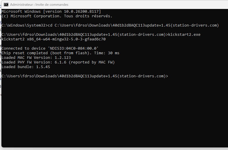

Connected to device 'NDISIO:14C0-00E:00.0' Error: RBL failed to start after issuing reset Failed load UpdateAgent Unable to flash
This is literally the error I get after modifying the IDs

Try the command kickstart2.exe to get information about the board and see what's missing.
