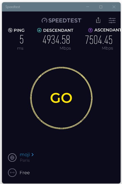

Caldigit has released a Marvell AQTION driver (PCI\VEN_1D6A&DEV_04C0) that is currently only compatible with the brand's hardware, but this suggests an official version is coming soon that will support all AQTION chipsets.
This emergency release by Caldigit resolves a compatibility issue with USB4 and Thunderbolt.
You can use it by forcing recognition, as I have done, and I intend to keep it until the official or complete release of the Aqtion chipsets( AQC107, 108, 110, 113, ... ), since I have a Thunderbolt 4 dock and a Z890 motherboard with USB4.
I plan to run some tests to see if there is any improvement, as I had noticed a performance drop between the Thunderbolt 4 dock and my USB4 ports with USB4/Thunderbolt 4 NVMe SSDs.

1st fast test on my IOCREST 10GB TB3 connected on USB4 on my Asus X870E Crosshair Hero.
It seems to be stable. I will try a bit more tomorrow because with previous drivers i've some packets loss on some games like Valorant and disconnections when i download with Steam.

I'm also experiencing no network problems on the internet or with data transfers to my NAS so far.
