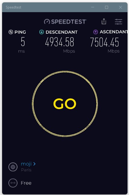

1st fast test on my IOCREST 10GB TB3 connected on USB4 on my Asus X870E Crosshair Hero.
It seems to be stable. I will try a bit more tomorrow because with previous drivers i've some packets loss on some games like Valorant and disconnections when i download with Steam.
