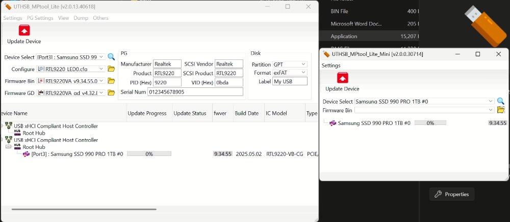

Yes, because MPTool mini no longer exists on the latest firmware versions and sometimes doesn't allow detection.
Try Mptool Lite, but be careful if you don't have an LED strip, because otherwise you'll lose the LED lighting (except for the activation LED, which remains active).

Hi,
I downloaded MPTool Lite Mini from www.station-drivers.com/index.php/en/com...tilities/lang,en-gb/
And upgraded successfully with my Ugreen RTL9220 box, It works normally
admin post=5192 userid=279 [attachment=1146]mptool.jpg[/attachment] I will try the update directly with the MPTool mini utility because it does not require a configuration file and I think it does not overwrite the configuration of the LED lights, I will confirm this afternoon upon receipt of a new Sabret RTL9220 RGB box [attachment=1147]Capture d’écran 2025-08-18 184117.jpg[/attachment] I confirm, it does not erase the configuration of the original firmware but it fails on the update, too bad

Confirmed that, It loss LED light after update fw 9.34.55
After upgraded, replug enclosure and then the LED loss, waiting for next stable firmware update
My enclosure is Ugreen 25665

I think that 9.34.55 miss LED bin file, so the LED is missing.
I tried to use older version 1.32.82 ( www.station-drivers.com/index.php/en/com...2.081123/lang,en-gb/ ), which had LED binary and the LED is bright, but it flashes very stranger.
