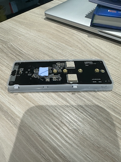

I unscrewed the upper case, remove SSD, and the shell as attachment.
Can you guide me more details how to disassemble to get the mainboard?
I tried using a flat screwdriver to pry it open, but I wasn’t successful.
I attached image link (I cannot attact image in this post)
drive.google.com/file/d/17sJWV3XlyDdn6_Q-QSUfCBJTS2Rc0kCW/view
drive.google.com/file/d/15gOTMEV5PMkI0XLKDEhPRM8Yh9TvJRUg/view

The Sabret can be dismantled easily, but the Ugreen, yours, is clipped on, so I don't know.

1 year 1 month ago - 1 year 1 month agoI managed to remove the mainboard and successfully restored the firmware. Ugreen’s product is very well-built, so taking the mainboard out was quite difficult. I’m currently using a rather old version, 1.32.82.081123, which enables the LED, but only one side works and it keeps flashing red continuously, which is quite annoying. I’ll just have to use it like this for now.The Sabret can be dismantled easily, but the Ugreen, yours, is clipped on, so I don't know.
