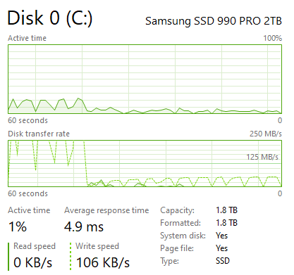

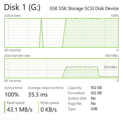

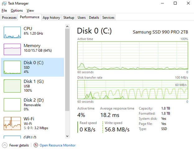

PROBLEM: Starts at 300 mb/s, then slows to 40 mb/s after ~10-30 gigabytes when COPYING FROM the enclosure. ***The limiting factor is the enclosure itself, see the attached photos

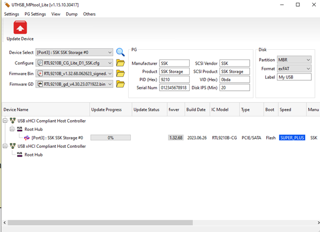

TROUBLESHOOTING: I have tried nearly every firmware update on this page using the stock 9120b configuration that comes with most of the files. I have also tried the SSK and orico configurations as well.
From the photos, it is definitely the enclosure that is the problem, not the computer itself. The connection is fine and it is registering at least 300 mb/s of sustained transfer before it slows down. This occurs on other computers, as well as while transferring to a non-shingled hdd that has 250 mb/s sustained write. I for the life of me cannot figure out why the enclosure is slowing down like this.

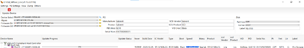

The attached image is the stock firmware and settings from the update tool. I also have now saved the configuration.
