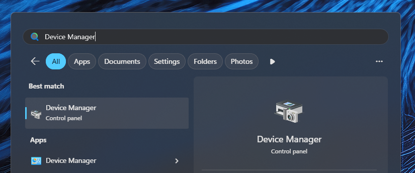

- Open Device Manager (one of the following)
- Press Win key + X → Device Manager
- Press Win key → type: Device Manager
- Press Win key + R → type: devmgmt.msc

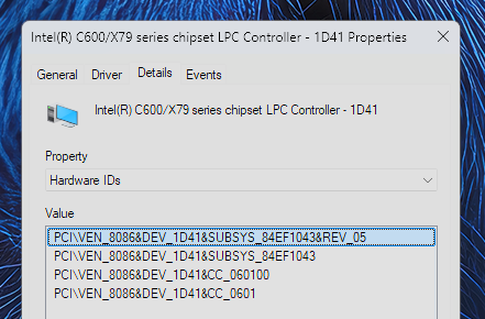

- If the HWID is not in the name, check the Hardware IDs property:
- Right‑click the device → Properties → Details tab → Property dropdown → select "Hardware Ids".
You will see something like: - PCI\VEN_8086&DEV_1D41&CC_0601
The part after DEV_ (here 1D41) is the device ID.

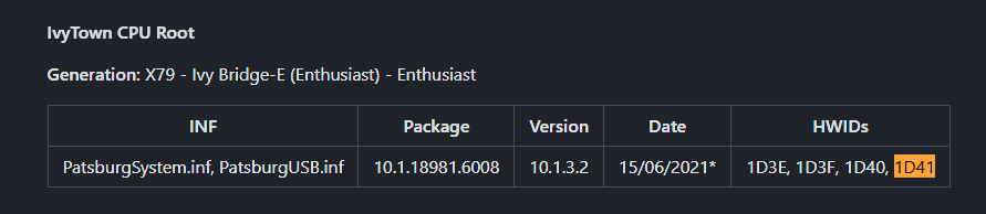

- Look up the HWID in the database I maintain on GitHub
Open my latest INF database in your browser: intel-chipset-infs-latest.md
Press Ctrl+F and search for that HWID (e.g. 1D41).
Note: If your device is not treated as a chipset component, or if it is a chipset device that Intel never included in any of its Chipset Device Software packages (i.e., the INF comes from Windows Inbox Drivers), the HWID may not appear in this database.
You will immediately see:- The latest INF version for that device,
- Which (latest) Intel Chipset Device Software package contains it,
- The date shown is taken from the digital signature timestamp of the associated .cat file (the catalog file that signs the INF files), so it accurately reflects when the package was released, even if the INF itself contains a dummy date like 1968/1970 – this happens because Intel no longer embeds dates in newer INF files.

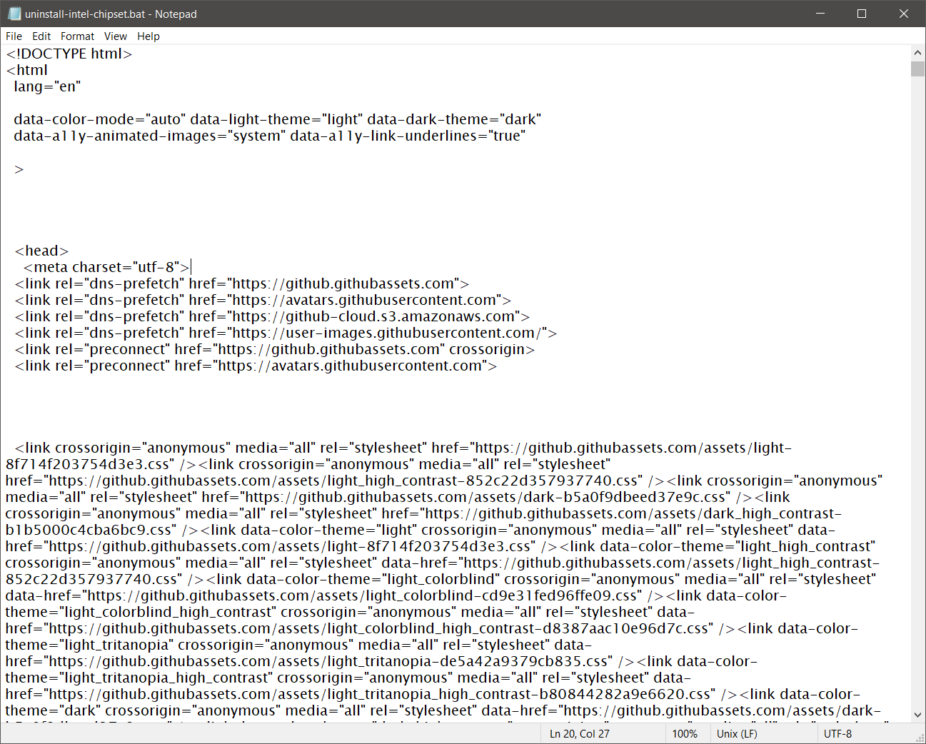

1. Tried R-clicking "uninstall-intel-chipset.bat" & "run as admin": nothing happens
2. Tried navigating to that file location at a "run as admin":command prompt window: output "the syntax of the command is incorrect".& "!DOCTYPE html".
Note: the official Intel chipset installer "intel_chipset_10.1.20404.8794" includes "SetupChipset.msi" which functions normally, by double-clicking.

I have no idea what you're talking about, because this new tool was created solely to fix error 1603 during MSI installation.
The files must be saved in the same directory:
- uninstall-intel-chipset.bat
- uninstall-intel-chipset.ps1
The only thing that popped up after I disconnected from the internet was an additional SmartScreen window.
After clicking "Run", it starts normally.
It's possible your antivirus is the problem...
I use regular Windows Security (formerly known as Windows Defender) from Windows 11 Pro, version 26H1.
The `!DOCTYPE html` error means you downloaded a GitHub webpage instead of the raw script files.

Opening your "uninstall-intel-chipset.bat" file in Notepad results with several thousand lines of code, starting with:
What purpose for all of these web links, if they're not being used?
