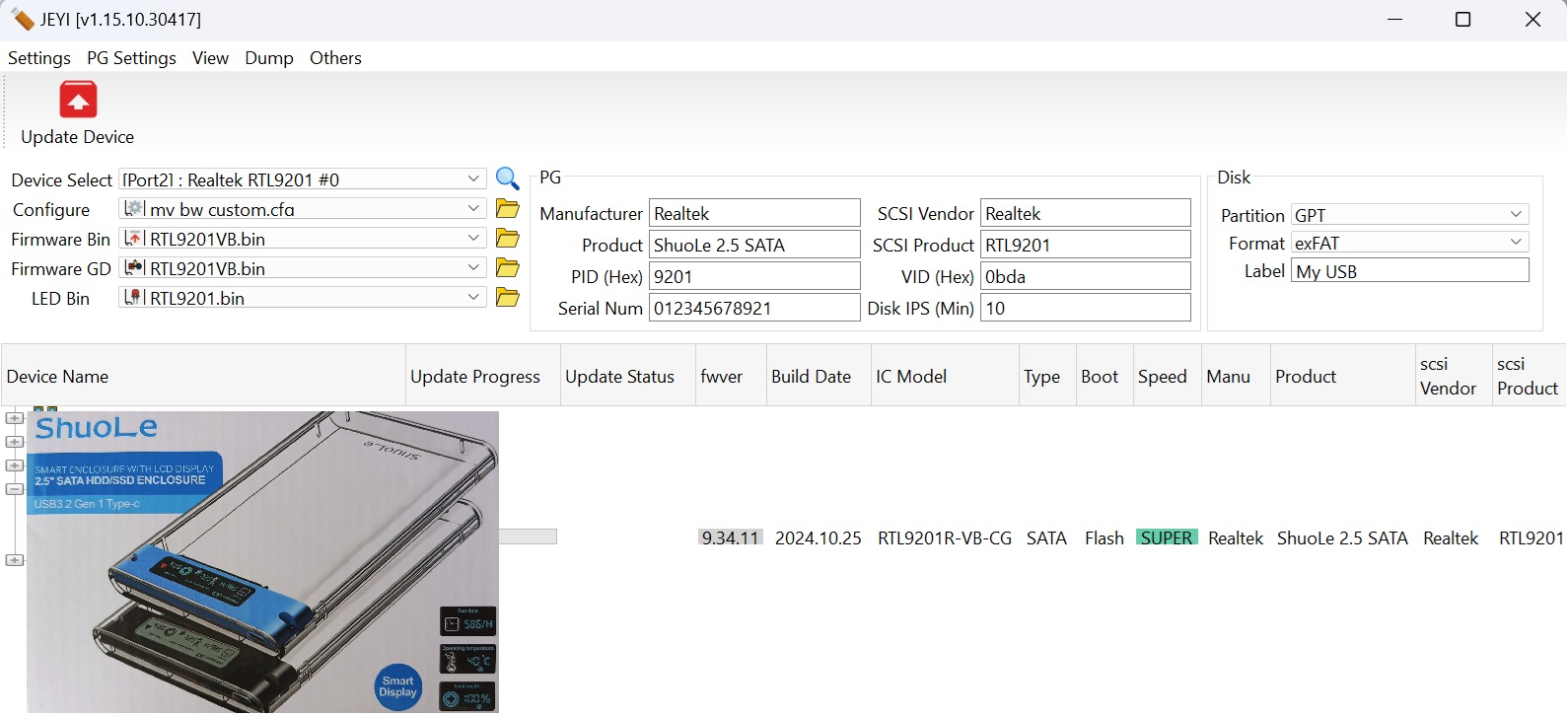

il y a 3 heures 40 minutesDid you flash it to 9201R? it wont select Firmware Bin for me with a 9201R plugged inExcellent firmware. PERIPH_API for LCD is now supported. I successfully flashed the ShuoLe enclosure with BW LCD.

il y a 3 heures 25 minutesYes.Did you flash it to 9201R? it wont select Firmware Bin for me with a 9201R plugged in

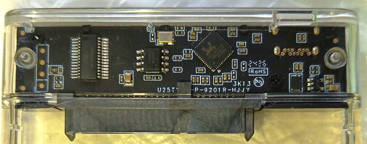

I think i know what the problem is some of my RTL9201R's have 2Mbit spi chips
this firmware is 452k so it needs 4Mbit though there's alot of FF's in the file so i may be able
to trim it down
Ok it can only trim down to 244 KB it wont flash to a 2Mbit SPI
I know a few of my pcb's have 8Mbit SPI's some 4Mbit some 2Mbit
I have checked a couple of my enclosures
Cofre Disco Duro x 5 = Flashable 4Mbit SPI (Have 1.33.88 but needs the correct LCD.bin will test flashing one at some point)
UTHAI/ShuoLe U25N-L x 2 = Flashable 4Mbit SPI (Have 1.34.29 So Newer Already and needs correct LCD.bin)
UTHAI Q5 x 4 Tested 1 2Mbit (Will Test rest later)
UTHAI Q6 x 6 Tested 1 2Mbit (Will Test rest later)
UTHAI Q7 x 6 Tested 1 2Mbit (Will Test rest later)
