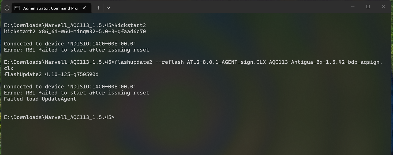

Re: Marvell/Aquantia AQC113CS (10Gbps) Firmware Version 1.5.45
3 시 36 분 전 - 3 시 35 분 전
You can try
flashupdate2 --reflash ATL2-8.0.1_AGENT_sign.CLX AQC113-DirtyWake_Bx-1.5.42_bdp_aqsign.clx
kickstart2
if it doesnt link you can try
flashupdate2 --reflash ATL2-8.0.1_AGENT_sign.CLX AQC113-Antigua_Bx-1.5.42_bdp_aqsign.clx
kickstart2
then shut down and pull power
Nothing works
