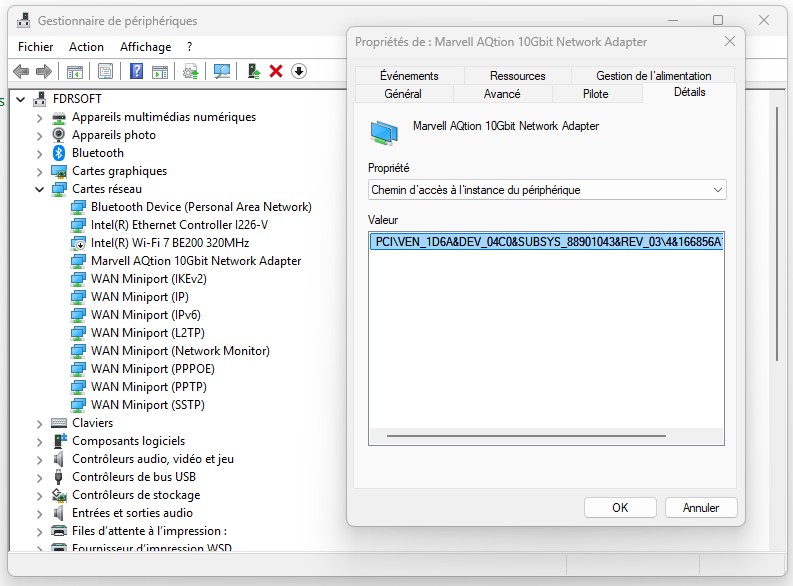

Okay, in Windows Control Panel, can you retrieve the Marvell ID?
Yes I can get all the IDs there.

So, modify the file to include the model ID.
If it still doesn't recognize it, try recovery mode.
Connected to device 'NDISIO:14C0-00E:00.0' Error: RBL failed to start after issuing reset Failed load UpdateAgent Unable to flash
This is literally the error I get after modifying the IDs
