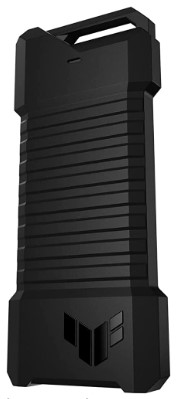

I'm going to do the test on my unionsime box too, otherwise my Asus Tuf box, no worries.
I'd like to hear your results.

RTL9210B_v1.32.49.041423 works fine here i used a cfg i made myself from a dump of the factory device information that was then customized

Version 1.32.16 cause problems with the box but no problem with the latest firmware and the Asus TUF 1.32.49 box even with the default Realtek RTL9210B config
Did you test the latest firmware with your Unionsine enclosure.
