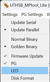

Boitier Sabrent
Warning!! On the Sabret case shown above, as with others, you will lose the RGB animation of the case (if it exists); only the activity light will work.
Before flashing, you unchecked LED in the menu?
  • admin 的個人頭像 Topic Author
  • 文章: 689
  • Thanks: 460
5 個月 2 星期 前
Yes, but unfortunately that also erases the LED firmware.
