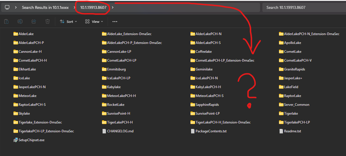

Off topic: if you want create your own Chipset pack installer starting SandyBridge, find these specific versions and merge all drivers in this order, overwriting when prompted:
10.1.17903.8106
10.1.19913.8607
10.1.20266.8668
10.1.20314.8688
10.1.20490.8818
10.1.20524.8822
By last, delete common*.* and null*.* as they are uninteresting.

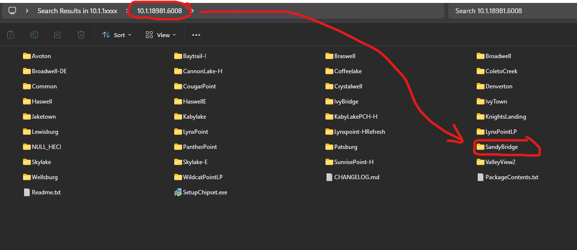

Why are you suggesting installation of Intel Chipset Device Software versions newer than 10.1.18981.6008 for SandyBridge platforms – after all, newer installers no longer contain INF files for this platform?
All Intel packages above this version will install as well, but I won't update any INF to SandyBridge because they simply don't have them.
I know... because I scanned all possible Intel packages - HERE .
The reason I created my updater was that installing newer Intel packages often only updates the installer entry in the list of installed programs, while the actual INFs remain unchanged. In practice, nothing gets updated except the installer itself.

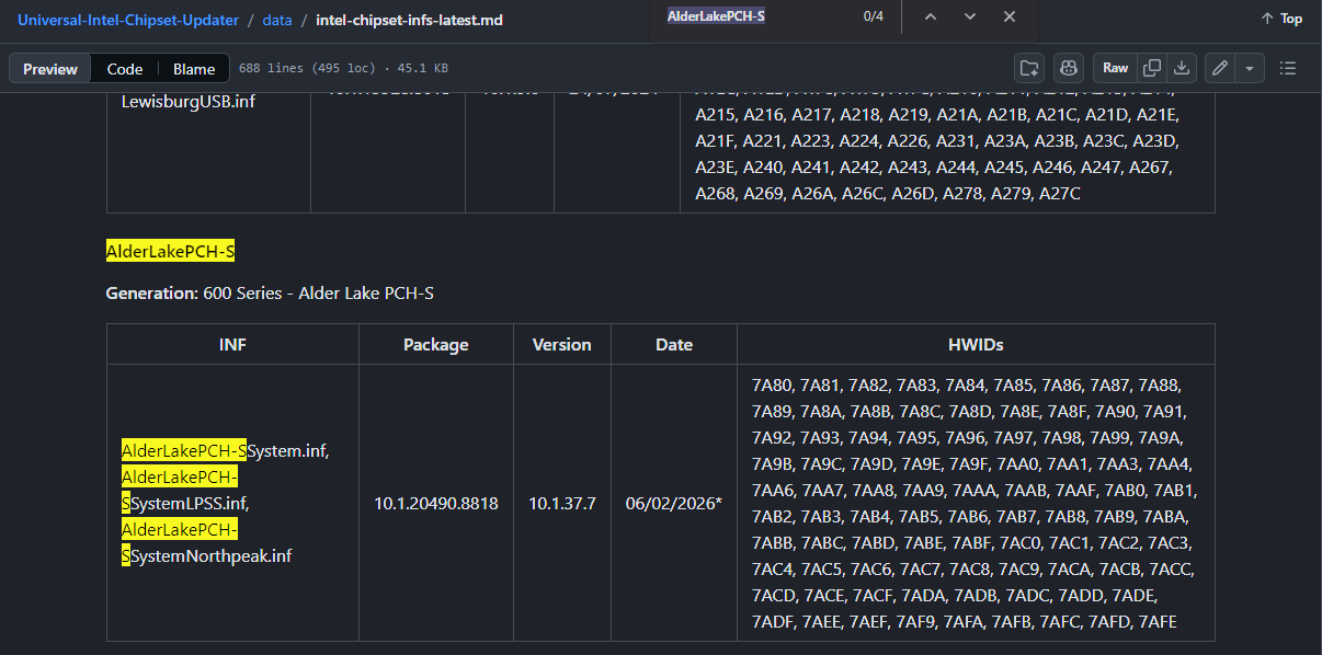

Purpose of my reply was only help people (like me) that are not authorized to use third party installers at enterprise environment. Of course sandybridge doesn't exist in recent packages, it's the reason I posted "merge" and "overwrite when prompted", some files exist only in selected packages.

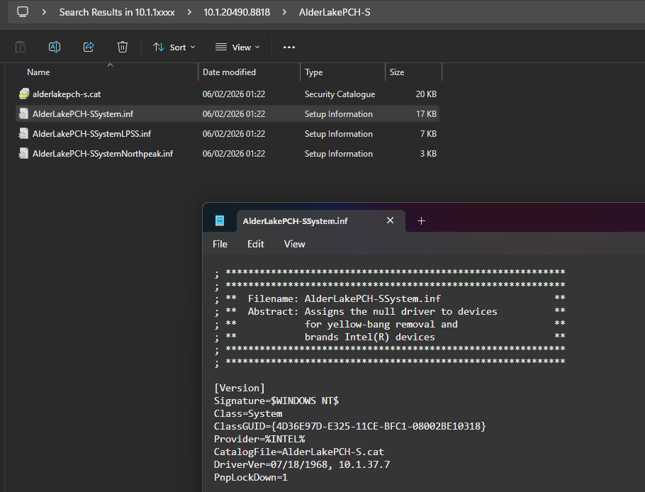

I've read carefully your project documentation and don't find any mention to AlderLakePCH-S version 10.1.37.5, is this specific version also being checked? I ask this because it has a specific HWID that's missing from most recent 10.1.37.7 version.

I fully understand that my unsigned script may not be suitable for enterprise use, but AI audits indicate that it has much more advanced security features than the official installers.
I understand that my project might be a bit overkill, but then people in corporations might benefit from it in other ways. In short, I build an up-to-date database of all INF files—which is available here . My updater uses this database to detect and install the latest possible official Intel installer, which contains the necessary INF files. If someone doesn't want to use my script, they can always look in the database and find out which Intel installer they need, then find it online and implement it in their MDM tools.
A quick tip regarding your case with AlderLakePCH-S.
And here's proof of what Intel Chipset Device Software 10.1.20490.8818 contains - and whether it includes INF for AlderLakePCH-S version 10.1.37.7.
I hope this helps you... even Intel doesn't have a database like the one I created.
My solution can be compared to a bazooka for killing a fly, because the problem with INF files is actually insignificant – they change only the device names in Device Manager 80% of the time (15% is driver mapping and 5% is system configuration DMA/ACPI/Registry). These are not drivers, I even created an article dedicated to this topic here . Even Intel doesn't take these files "seriously" because it sets the date as the day Intel was founded (this tells you that these files are less important). I just wanted to show how to professionally solve the problem of installing new INF files - it was a fun project to exercise my brain.
