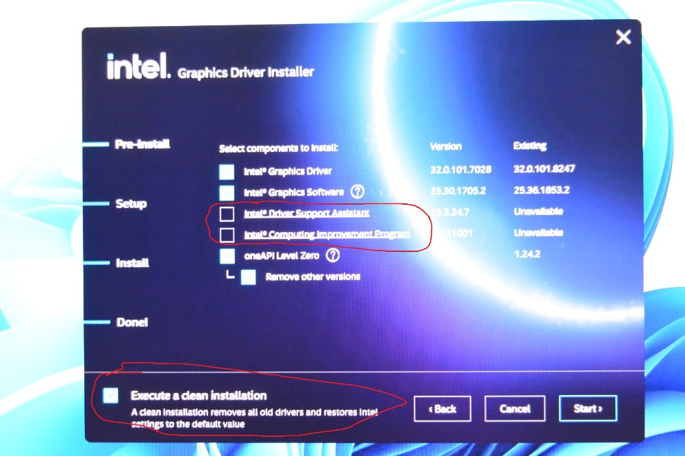

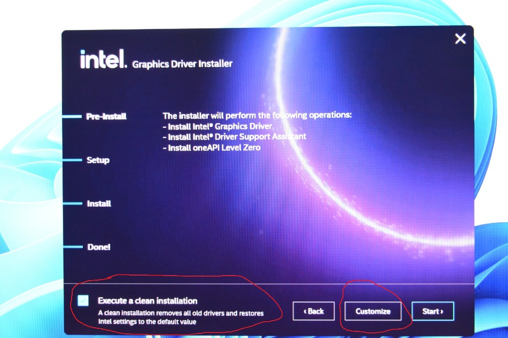

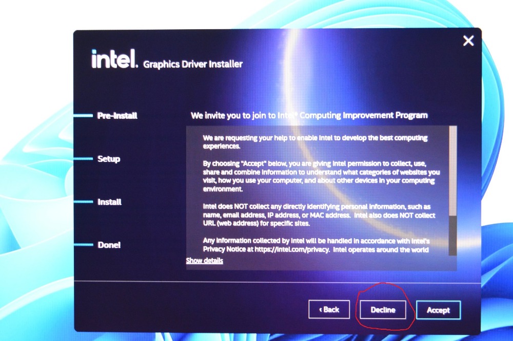

I thought I would share a problem that I was having with my ASROCK B580 Challenger card that was causing a lot of BSOD's or Blue Screens of Death.
I went onto the Intel forums and the Moderators told me that there is a problem with the Intel software called Intel® Computing Improvement Program it can cause your your PC to BSOD at random which happened to me 4 to 8 times a month until the Mod's at the Intel Forum told me how to fix it.
When you install your graphic's card driver you need to not install the Intel® Computing Improvement Program software and when it ask's you if you want to you need to select Decline,then you need to Execute a Clean Installation and after that you need to make sure that Intel® Computing Improvement Program and the Intel® Driver & Support Assistant are both checked off.
After doing this I have never had another BSOD and my system runs very stable.
I attached pictures to this post below in the correct order that you will get the screens when installing the driver.

Personally, this doesn't affect my Z890 with Intel Core Ultra drivers; it must only affect ARC cards.
