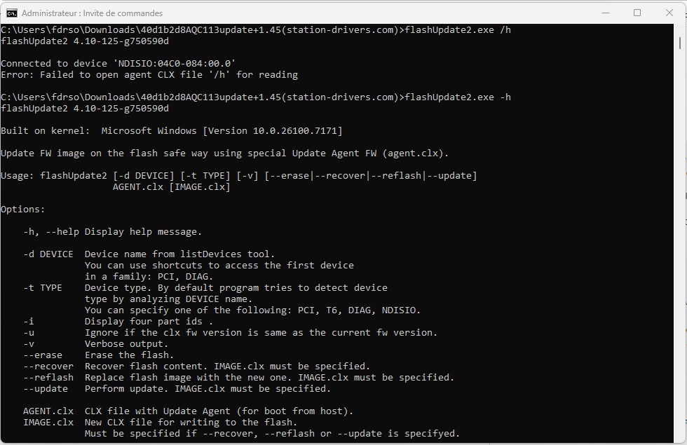

Here is the command for firmware recovery:
flashUpdate2.exe --reflash xxxxxxxx.clx

6 meses 4 semanas antes - 6 meses 4 semanas antesConnected to device 'NDISIO:14C0-00E:00.0'Be careful, as some external PCI-E cards (probably not Rev 3) are not compatible, so read the messages carefully.
AQC113 Firmware Flashing and Recovery Notes · GitHub
Otherwise, I haven't had any problems with my Z890 ProArt so far.
Definitely do a clean install of your old firmware.
Error: RBL failed to start after issuing reset
Failed load UpdateAgent
Unable to flash
Also this error
flashupdate2 -i
flashUpdate2 x86_64-w64-mingw32-4.10-126-g5407c89
FourPartIDs:0x0000:0x0000:0x0000:0x0000
Última Edición: 6 meses 4 semanas antes por misal1337.

The chipset is recognized; if so, try with a different firmware or the last one that worked.

Same error with other firmware. Tried it by booting into Hiren Boot PE. Windows can recognise the card and HWID shows the correct 4 parts. But updater doesn’t see. Only sees 0000 0000 0000 0000. It cannot reset the card as well.
