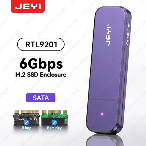

Another Jeyi enclosure with a newer chip. RTL9201-VB-CG with 9.34.11.
Device : [Port2] : Realtek RTL9201 #0
U2PHY : n/a
U3PHY : n/a
PID : 0x9201
MANUFACTURE : "Realtek"
PRODUCT : "RTL9201"
SERIAL : "012345679085"
SCSI_PRODUCT : "RTL9201 "
SCSI_VENDOR : "Realtek "
USB_SELF_PWR : n/a
DISK_HOTPLUG : 0x03
LED : n/a
PINMUX1 : n/a
PINMUX2 : n/a
U2_MAXPWR : n/a
U3_MAXPWR : n/a
ASPMDIS : n/a
DISK_IPS_THRES : 0x0a
CUSTOMIZED_LED : 35 01 02 00 00 00 00 00 00 00 00 00 00 00 00
DIS_SHOW_EMPTY_DISK : n/a
UART_DBG_PIN : n/a
SUSPEND_DISK_OFF : 0x01
CUSTOMIZED_FEATURE : n/a
PERIPH_API : n/a
RAID_CFG : n/a
FW Ver : 9.34.11
FW Build Date : 2024.10.25
IC Pkg Type : SATA
Disconn_ForceUSB2 : false

I know it's not a troubleshooting forum, but my SATA NVME keeps getting disconnected in this enclosure. The whole drive just disappears. I was successfully able to do a full 240GB h2testw run, getting it to 65 degrees, without disconnecting. But whenever I leave it idle for a minute, it's gone...

I know the problem your talking about
I have spi dumps of other firmware but not flashable with the realtek tool
only a ch341a
1.32.7 is fine (we have a realtek flashable updater from windows
9.32.74 does that also the drive will just disapear at random when not doing alot (i only have a spi backup from a Cofre Disco Duro)
1.33.88 is fine (i only have a spi backup from a Cofre Disco Duro)
If it was me i would try and get the updater from the forum or take a spi backup
then flash 1.32.7 and see if its fixed you could then roll back to 9.34.11 if required if you had a backup or the updater for 9.34.11

11 ชั่วโมง 22 นาที ที่ผ่านมาDo you suggest me trying to flash 1.32.7 from your opening post ? After making my own custom .cfg using these instructions ? I don't know how an SPI backup works, but it sounds like it's a chip backup made by connecting it in some direct hardware way.[...] 1.32.7 is fine (we have a realtek flashable updater from windows
