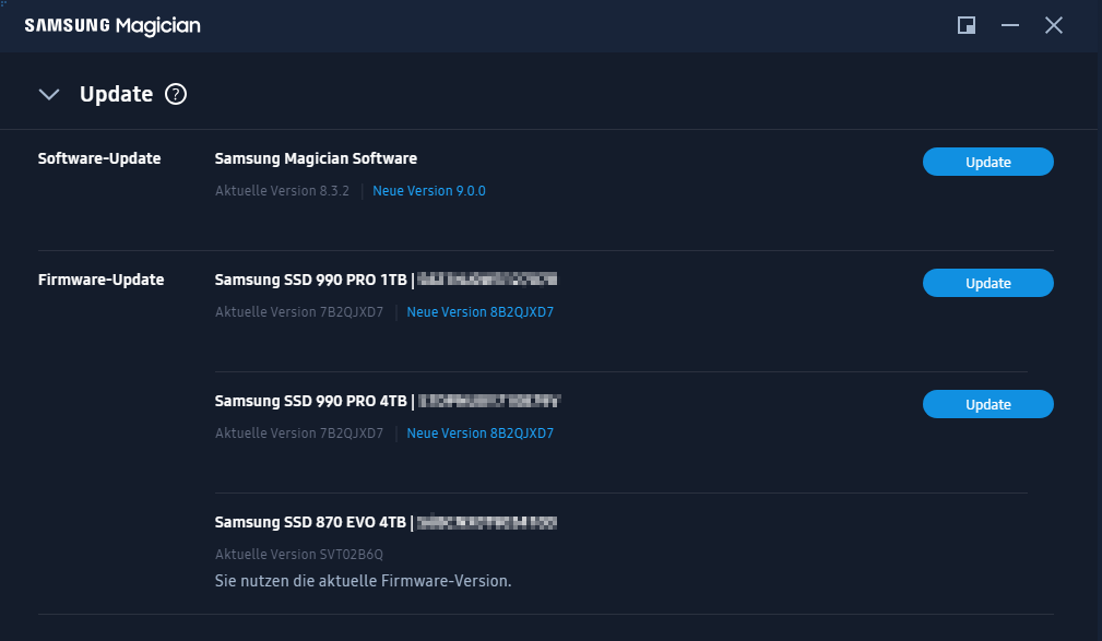

Just got update for both 1TB and 4TB.
Still using old version of Magican.

I had it on my 4TB 990 Pro the other week first time i have had anything like that with any of my 990 Pro's
the game i was playing on that drive just took forever to do anything
the drive was in some sort of super limp mode
reboot = same
shutdown = fine
